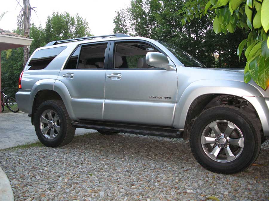

Hey.
Yes, I installed a lift using a set of Old Man Emu coil springs (1" higher) up front and a 1" spacer in the rear, I originally went with springs in the rear but it was too harsh of a ride.
No rubbing at all.
