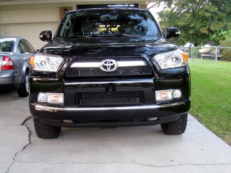

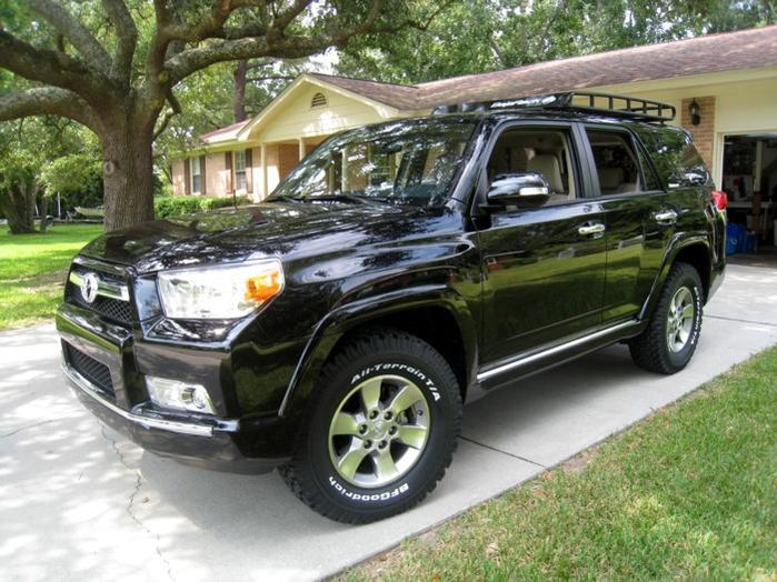

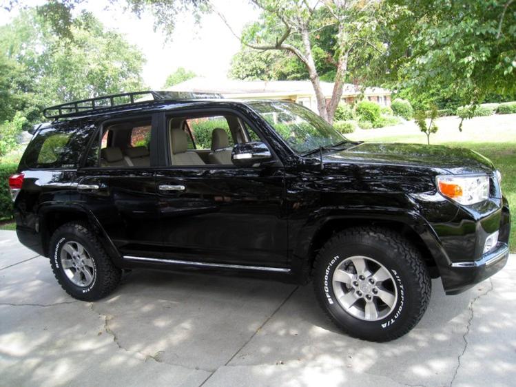

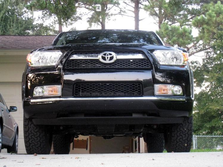

275/70/17 BFG ATKO's installed on Limited

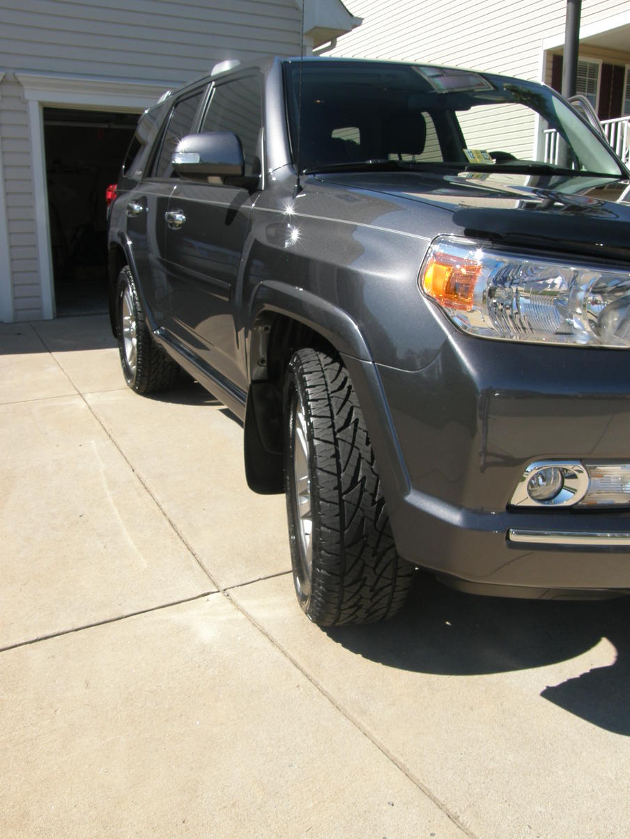

It's been posted here before, but 275's work fine on the stock Limited rims. I put 275/55-20 Bridgestone Dueller Revo's on my stock Limited rims. I had these tires on my Gen4 and they did great in the snow. Ride nice, no rubbing and much better looking than the wagon wheels that came stock on the Limited.

no problems at all. Still rides smooth and I just took a trip to the Outer Banks and didn't notice any decrease in mpg. I'll post some pics if I ever get home from work before dark...probably this weekend. A few others on here have mounted this size also reported no problems. I had BFG's on a gen3, revo's on a gen4 and now Revo's on the Gen5. The BFG's were very good, but I found the Revo's to be just as capable (at least for my use) and a little smoother on the hwy.

so long as the overall diameter changes less than a percent or 2, the speedo should be fine. The 275/55's are approximately .3 inches taller than the stock set up. Basically this means at 75 on the speedo, I'm actually doing something line 74.25 (ish) - I highly doubt the speedo is that accurate anyway. I did put the cruise on 70 and look at a handheld gps which showed I was going 70...granted, not the most accurate test, but close enough for me.

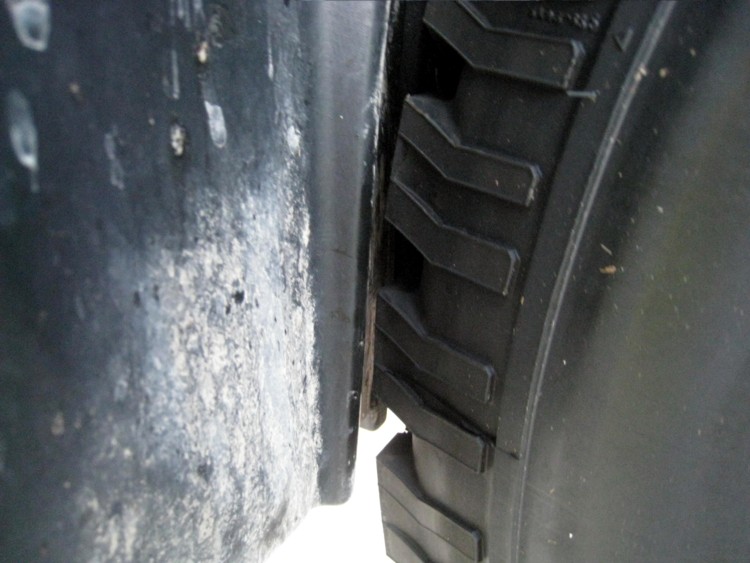

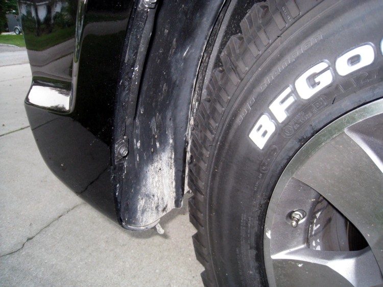

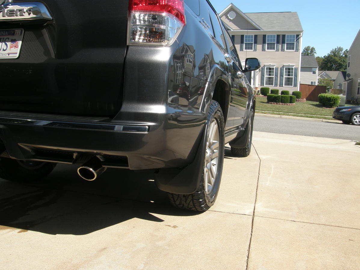

mudflaps
Did your came with the mud guards or they are add on ?.
They're the husky liners. There okay. I'm not thrilled with them, but they do keep things from flicking up onto the paint. They have a lip on bottom on the inside that catches mud and I imagine snow will accumulate there. Not a big deal, but I liked the stock ones that were on my Gen4 better. I called my local dealer and they wanted $52 per flap. $208 for mudflaps seemed a bit steep. I also added the side moulding from britetrim. That I'm quite happy with. They matched the paint perfectly and while I liked the clean look without it, it has saved me from at least one door ding.
Thanks for replying. They look a bit small IMO, but they are helpful for sure.
I am thinking to have them install on mine, I like the stock one but agree at over $200.00 is a little bit high.

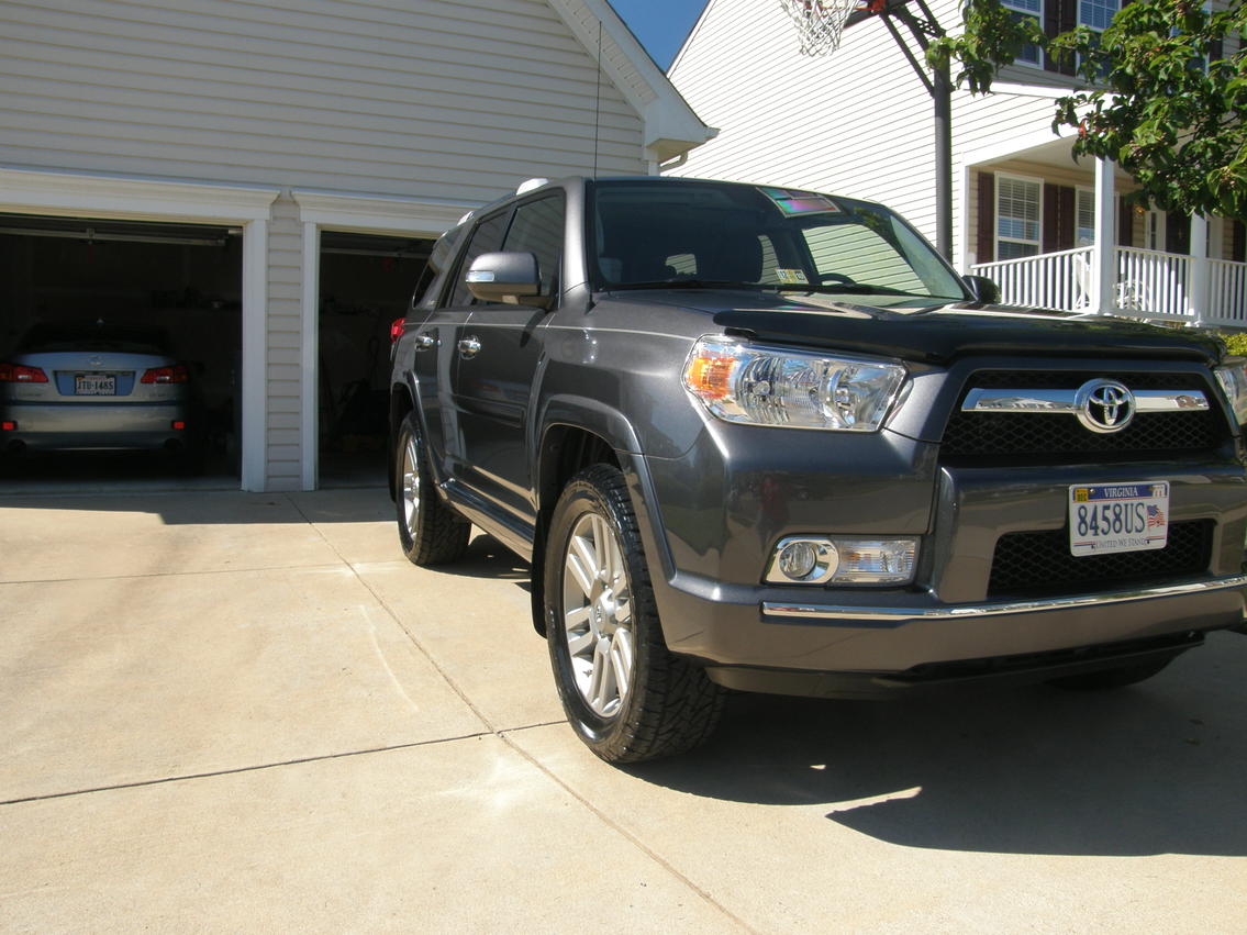

How about noise with those tires? I like how quiet my Limited is on the highway, but I hate the skinny tires. I really like the look of yours, but the grooves look like they may generate some road noise. Do they?

This is what lead me to these tires on my gen4. While they're not quite as quiet as the stock tires, they're very very close. My main reason for going to them was for the added traction in foul weather, but they seem to be a good blend of better traction and ride quality/noise. I'd highly recommend them.
