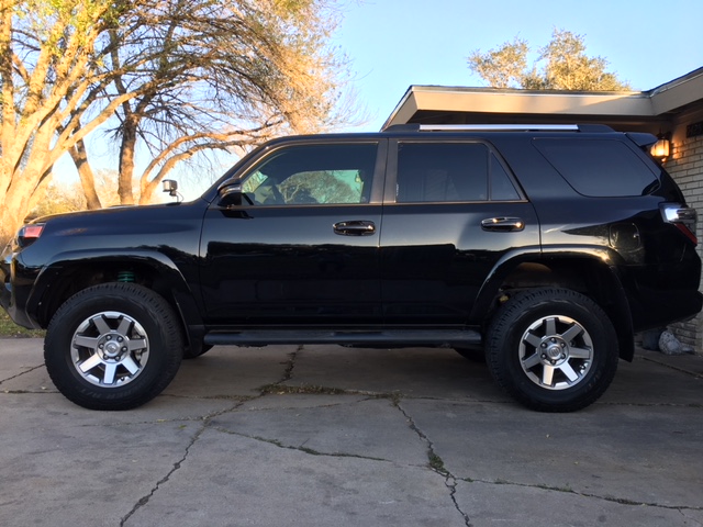

Here's mine
Here's mine with stock rims; lost just under 1mpg with 2.5" in front and 1" in rear. 275/70/17 Cooper AT3's
I said "no noticeable drop in MPG's" because 0.5~2mpg can be attributed to driving conditions, load, and traffic, those numbers are negligible because of those factors, now if it's a control environment maybe we can actually get a definite answer.
