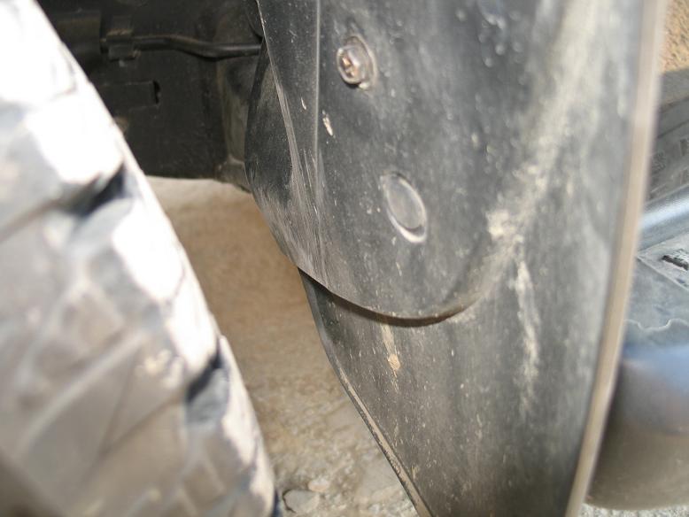

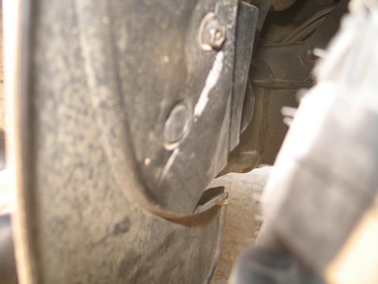

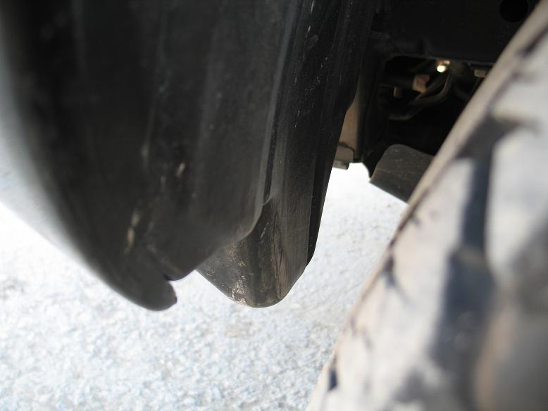

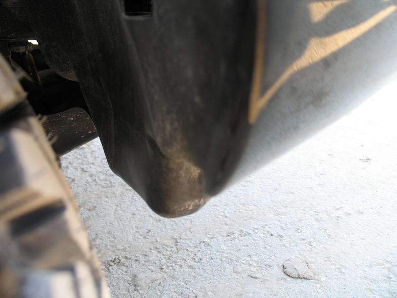

I've put Goodyear MT/Rs this afternoon on my truck. Finally. They've been in my garage for a month; I was waiting good weather to put them on.
After I put them and made a test drive around the block (~5miles), I did mentioned rubbing. I knew it's going to rub a little, but after what I saw, I start worrying.
They rub not only mud flaps, but ALL triangles on the front bumper. I was expected a little rubbing on triangles. So I checked how much should I trimmed. I'm not sure if after removing triangles I would get rid of rubbing. Maybe in city driving yes, but what about off-roading when I'm using all wheel travel up and down. I'm afraid that 275/70-17 might rub the plastic fender when the shock will be fully compressed.
May be I'm wrong, that's why I'm asking for an opinion from members of this forum. I talked to the guy I got my tires from and he said he will check with GoodYear, if I can exchange 275/70-17 for 265/70-17.

Right Mud Flap
I've cut it, but looks like still rubbing

Dude thats bad. You have to trim that plastic or downsize tires. Sorry to hear, that got to be frustrating.

You do not need to cut your trim. My tires also rubbed after i installed my 1.5" wheel spacers on stock rims with 265's. I cut some but the majority of the plastic, I just got a good lighter, heated up the trim and remolded the touching plastic inwards. Just keep pressure on the heated plastic until it cools and holds the shape you want.

Interesting.... Can I use heatgun? I think so.
What about mudflaps? Do you off-road?
If you off-road often replace stock mudguards with Jaos. Stock is just good enough for light use. Get something like this:
I still have stock mud guards on. My tires stick out about 1 inch from wheel wells, so my runner does get somewhat dirty but no big deal. I cut and heated my mud flaps to fit.
Go to a wheel alignment place. They can adjust your settings to reduce the rub.
My 275's don't rub except in extreme offroad and its only plastic - no issue.
