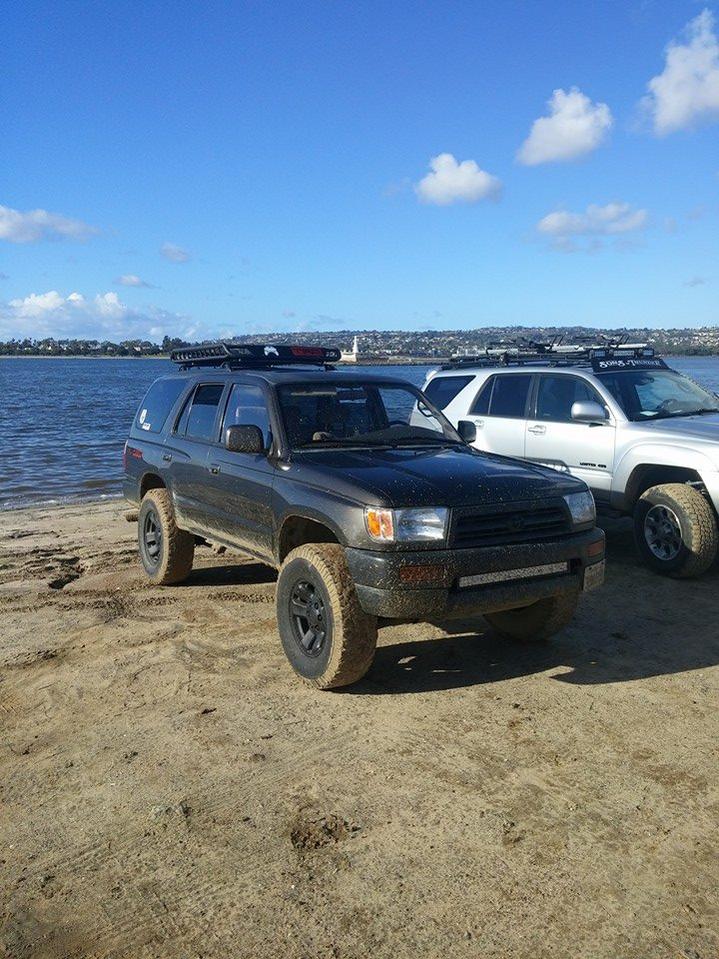

i have a 2inch lift for a 2wd. sits about an inch taller than stock 4wd. im getting tires by the end of the month and want to know it 285/65 would fit?? i will be getting spacers so they dont rub on the UCA but im wondering how bad the rubbing might be on the body. my current setup is 265/75r16 no rubbing at all.
also, reason for getting bigger tires is, im installing e lcoker rearend with 4.30 from my 2wd with 3.73. huge difference.
current setup
Well your going to have some rubbing on the pinch welds so expect to break out the hammer and most likely some rubbing offroad with only a 1 inch lift. But you wont know how much until the tires are installed. The brand and type of tire also play a roll.
