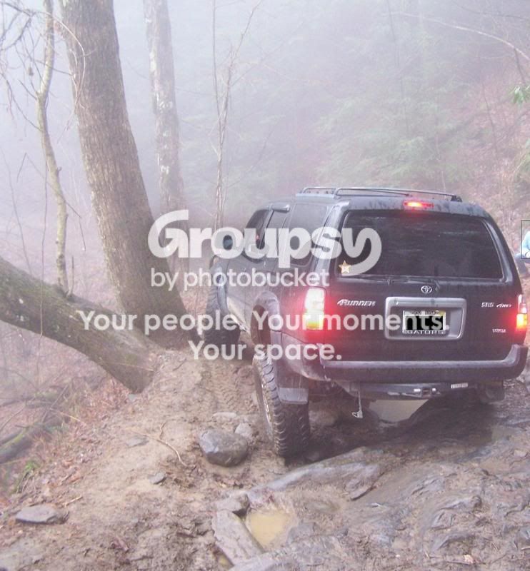

i would say i do moderate to heavy offroading with my truck, and i still have the stock 4.10 gears. when i can afford to, i plan on changing to 4.56's and arbs, but for now the 4.10s handle the 33's fine for anything i do offroad. you will lose mpgs and some acceleration, but these trucks arent fast to begin with.
