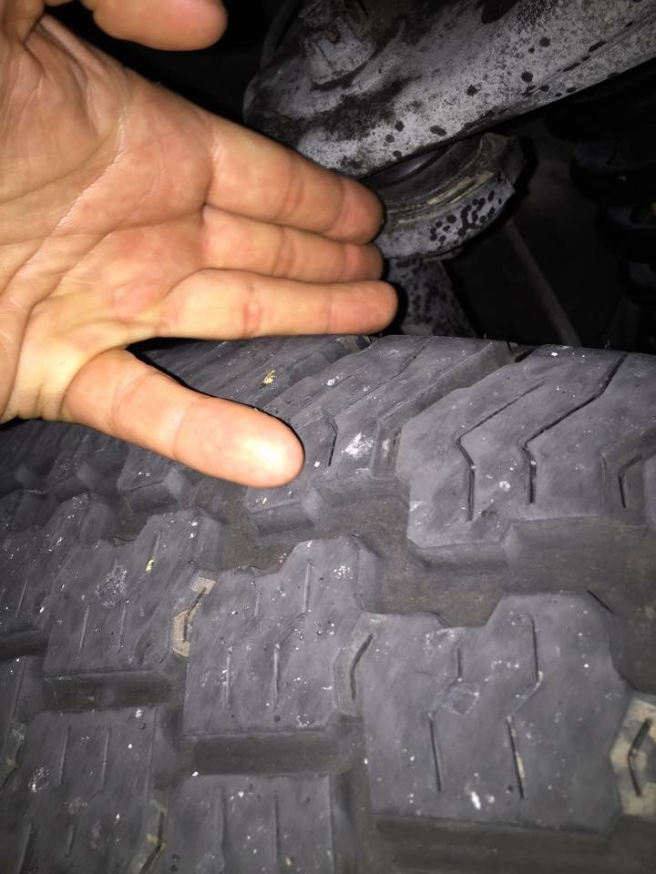

Will 285/75s fit ?? Currently running 16x8s wheels with -5mm offset and 265/75 tires, I have a 99 4x4 5 speed with a 3'' OME lift. I tried to find a thread that would help me with these specific measurements but no luck. Appreciate all the help fellas.

I'm running 285/75/16's on a -6mm. Been running them for a couple years with no spacers, and stock uppers. I've had no problems.
I ran 285/75/16 with stock arms on stock rims. And had about 1/4 gab between UCA and tire. Now running built right UCA and have much more clearance.
