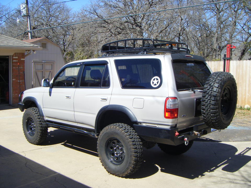

I would go with LC OME861 OME COIL SPRING FRONT LOW HEIGHT, HEAVY LOAD 10MM/3/8-INCH 80 SERIES for the rear to level with OME882 for the front. I'll be changing mine to LC OME861 to get the same height like this rig. OME COIL SPRINGS

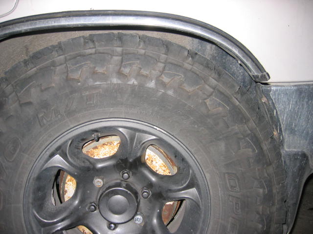

My experience on offroad with three inchs OME coil spring at the rear and 285/75/16 and rub like crazy so I installed 2"BL and in the future I'll be running 315/75/16 and change my coil spring to LC OME861 to level my 882 at front. If you are staying on 285/75/16 you can get away with 1 inch its better 1.5 body lift from 4Crawler Offroad.
