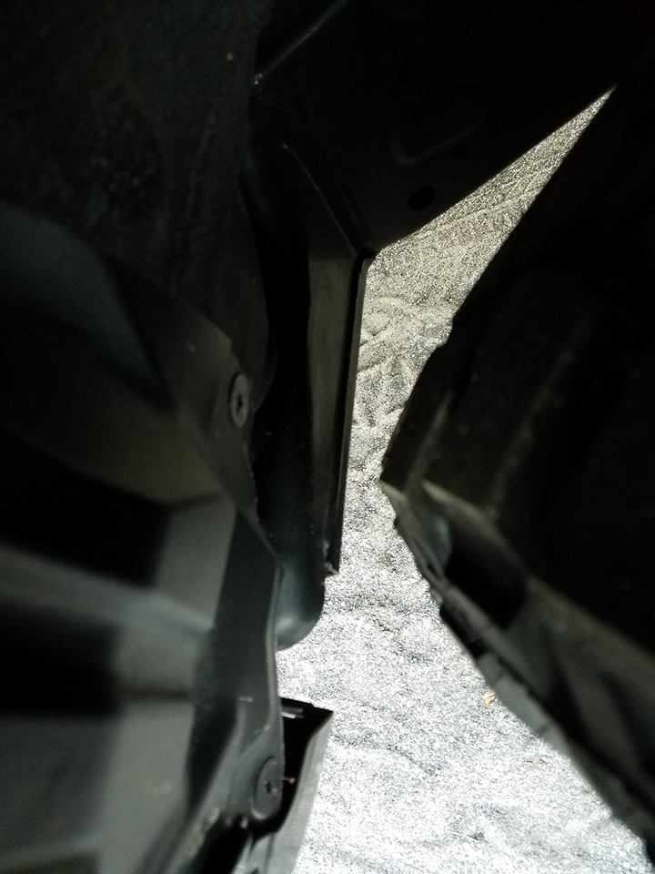

3" lift, 17x8 wheel with 4.5" BS and 0 offset. 295/70/17 Ridge Grappler which runs big in the 295 family. Moved the inner fender forward and trimmed the front bumper. No BMC needed, no rubbing, very happy.
My lift is only 1.5 plus 1 inch stock height in the front and 1 inch in the rear. Based on what I am seeing and reading, I will definitely need a BMC and trim more on the bumper to fit 295s. For now, I am happy with my new 285 KO2s haha.
