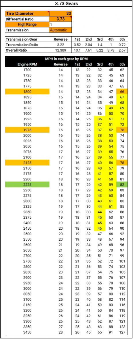

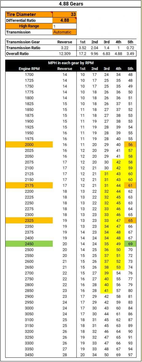

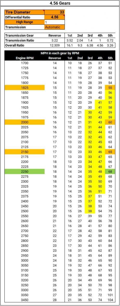

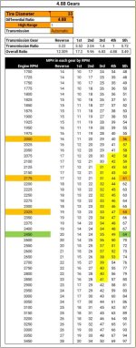

Attached/below are thee gear ratio comparisons. With the lighter trailer you're using, the 456s will allow better cruising. The 488s will limit highway cruising more when not towing.
My thinking was to focus highway speed towing somewhere between 2000 and 2100 RPMs. That's the yellow highlighted ranges.
