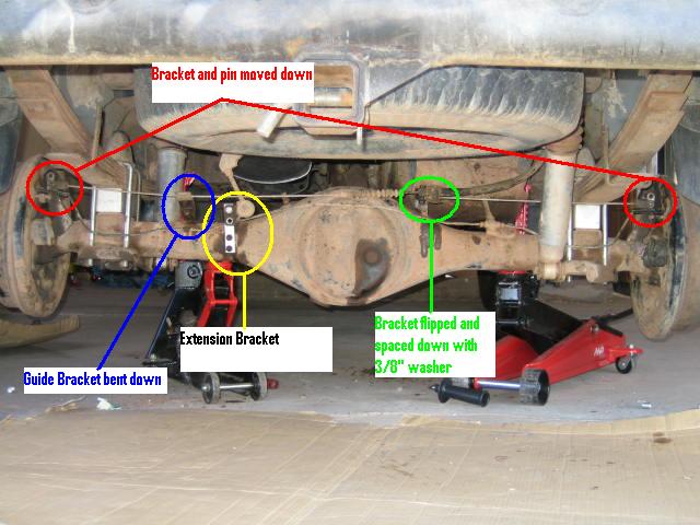

The old u-bolts were a pain to get off, one broke. After removal, and lowering of the axel, I was able to slip the 2-inch blocks ($18) under the leafs, aligning the nubs with the holes both top and bottom.
I soon realized that there were a few problems.
1) The path of the parking-brake cable used to go over the leafs, now it is too tight, so I tried going under. Not much better. I drilled a new hole approx. 3/8" under the original and installed the bracket and clevis-pin with cotter-pin.
2) The guide bracket for the cable going to the driver side still kept the cable pretty high. I simply bent it down until it looked good.
3) The pivoting bracket (above and right of the diff) was such that the cable to the left was on bottom and the cable to the right was on top. Since the distance to the right is so much shorter, there was not space for the cable to get beneath the leafs as good. I flipped it over as well as re-attached it under the bracket on the axle and spaced it down a bit more with a washer.
4) To keep the load sensing Brake Proportioning valve proper, I drilled some holes in a piece of Al flat bar to move the it up 2 inches.
