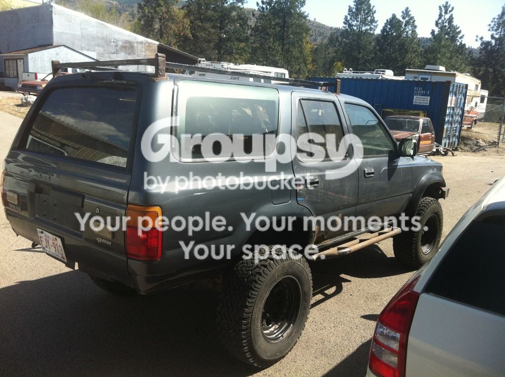

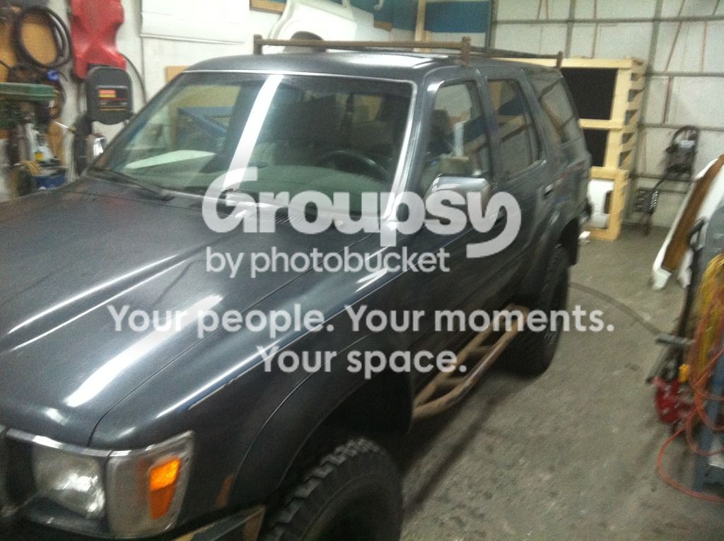

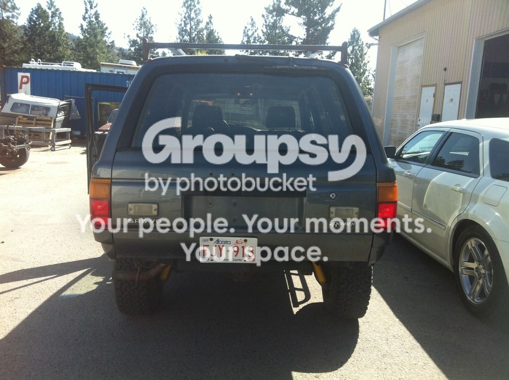

Nick rolled in today for his booked appointment to have his second gen 4Runner 1/4rs installed
IMG_0102_zpswsaavmu7.jpg~original
IMG_0103_zpsccpgrrzt.jpg~original

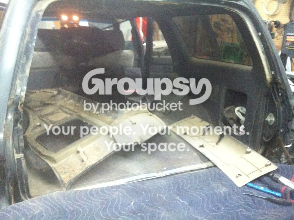

got started by pulling the interior out
IMG_0104_zpsn2xd3gia.jpg~original
IMG_0106_zpsym0xno5r.jpg~original

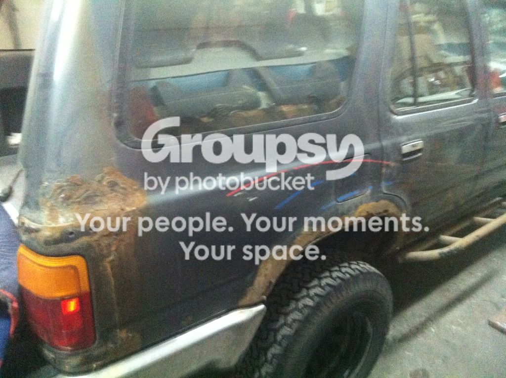

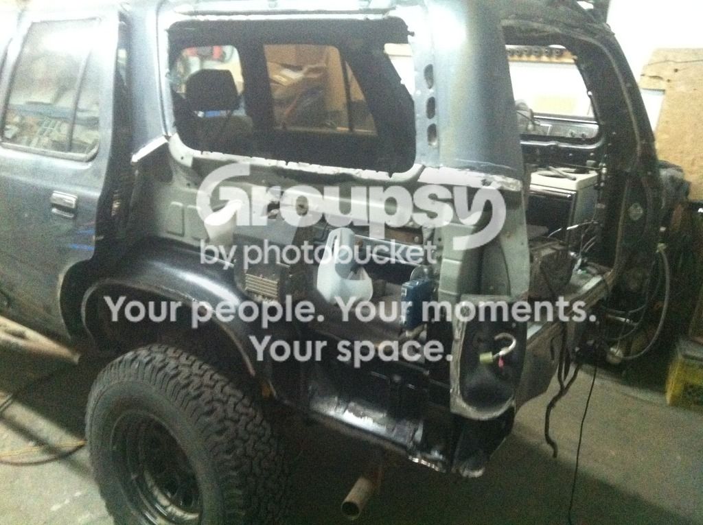

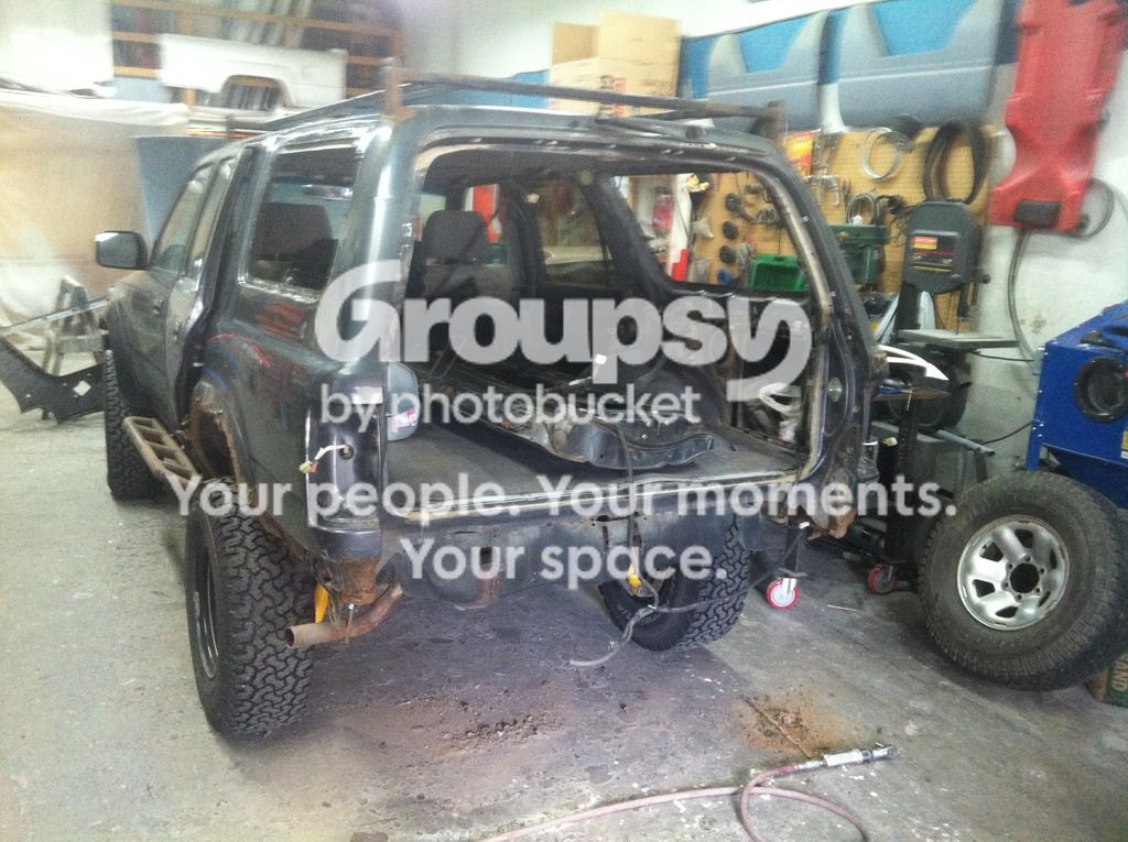

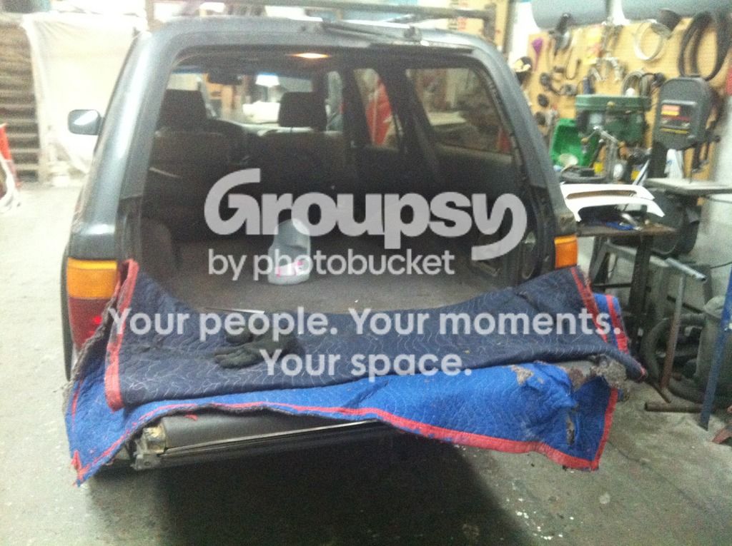

got the rest of the interior out , and removed the rear hatch
IMG_0113_zpsrdpwdp23.jpg~original

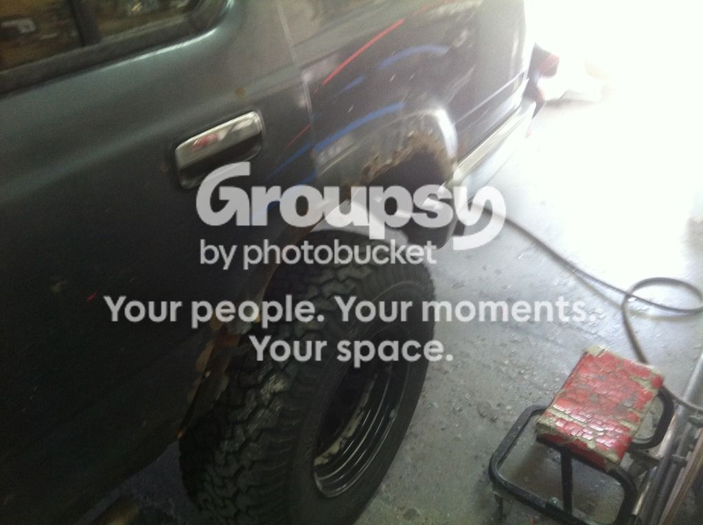

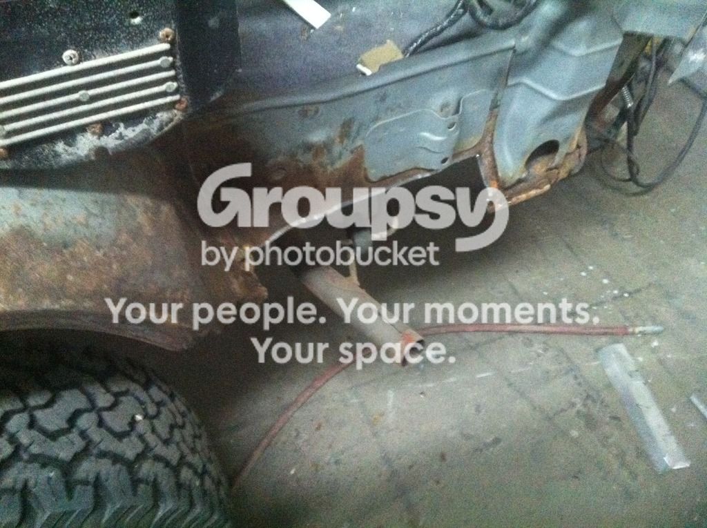

also removed the drivers flare , and as suspected , it's the same as the passenger side
IMG_0109_zpsiklabl0x.jpg~original

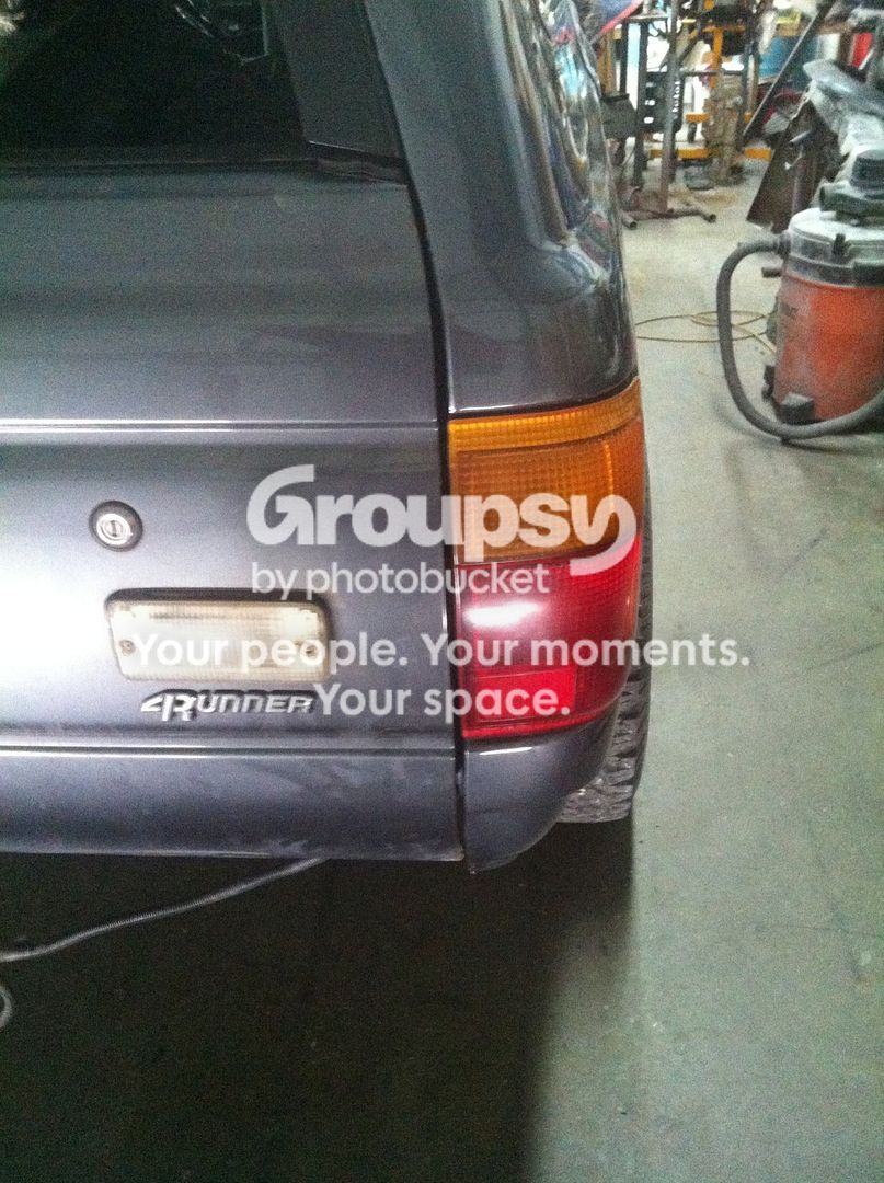

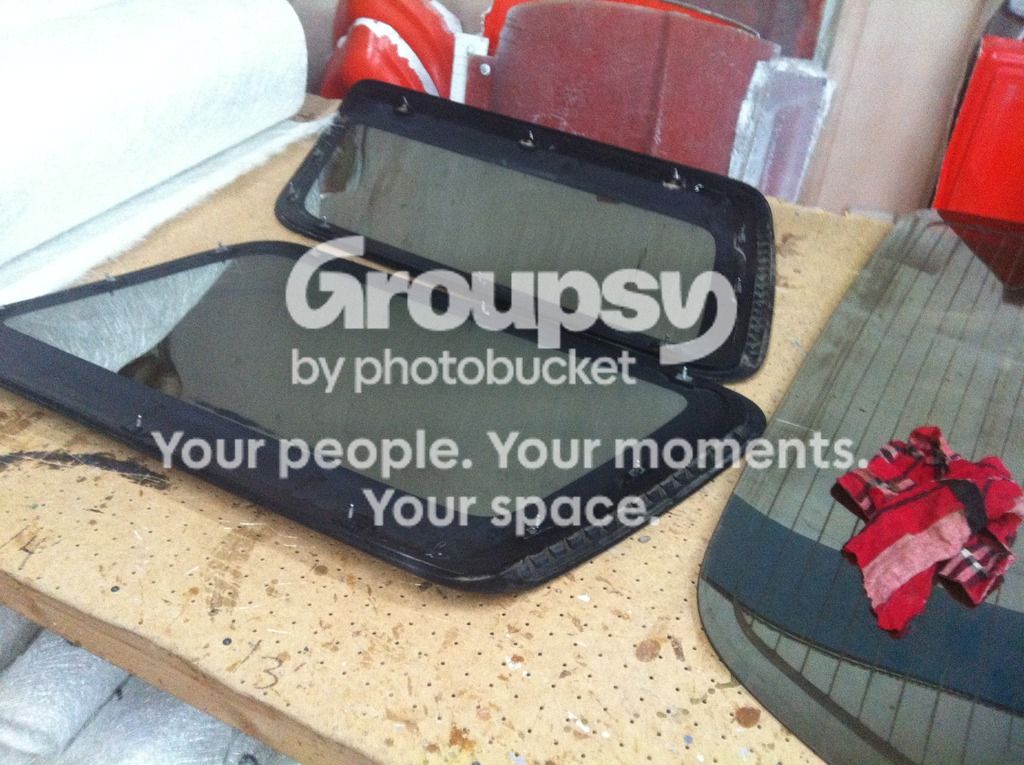

also , got the rear 1/4r windows removed
IMG_0123_zpswxmrytw6.jpg~original
ugly job , I wear rubber gloves with cloth gloves over top , soaked in wd40 ..

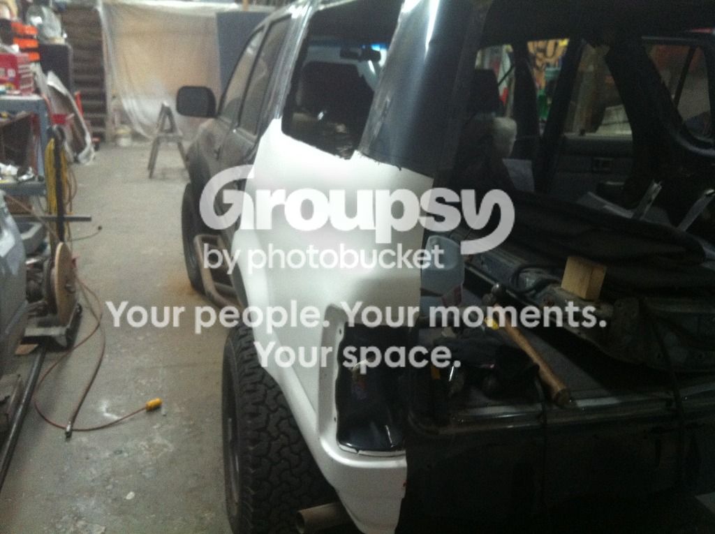

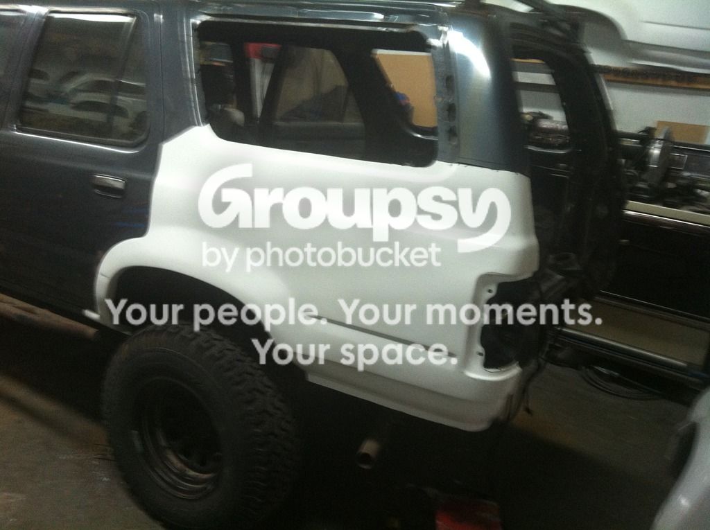

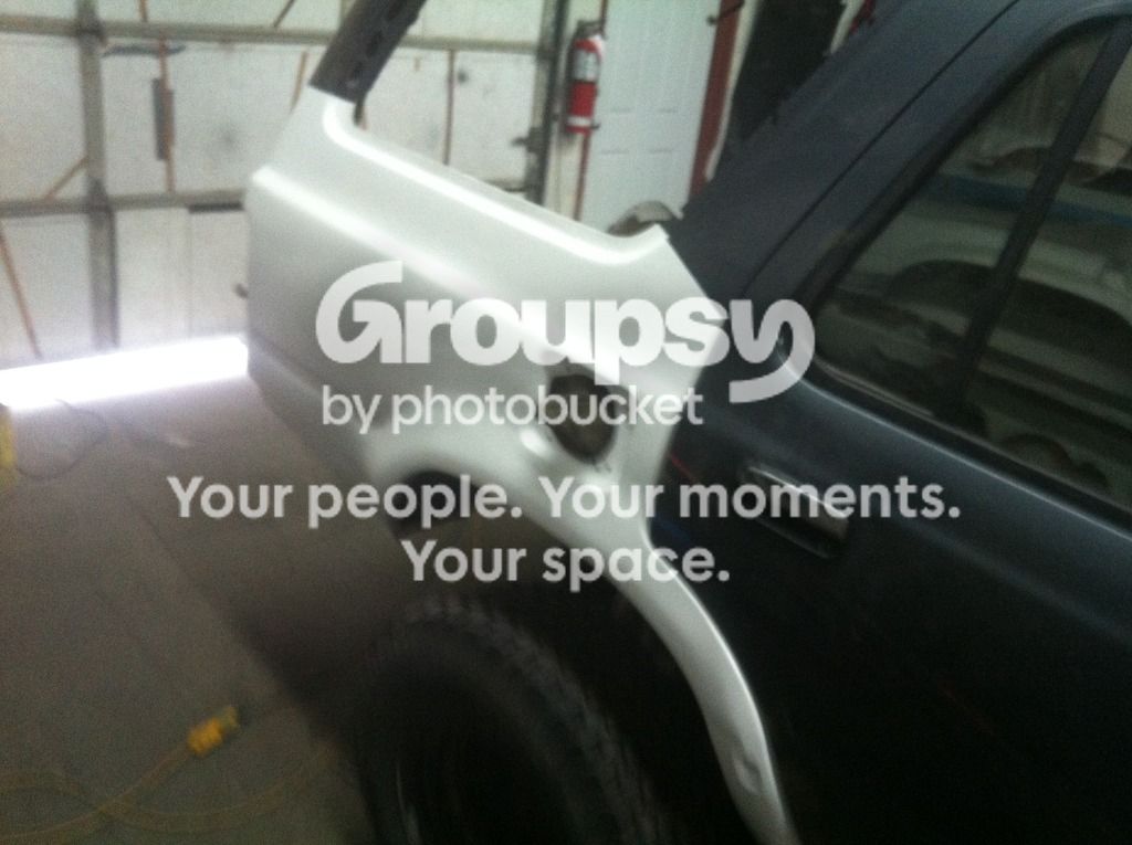

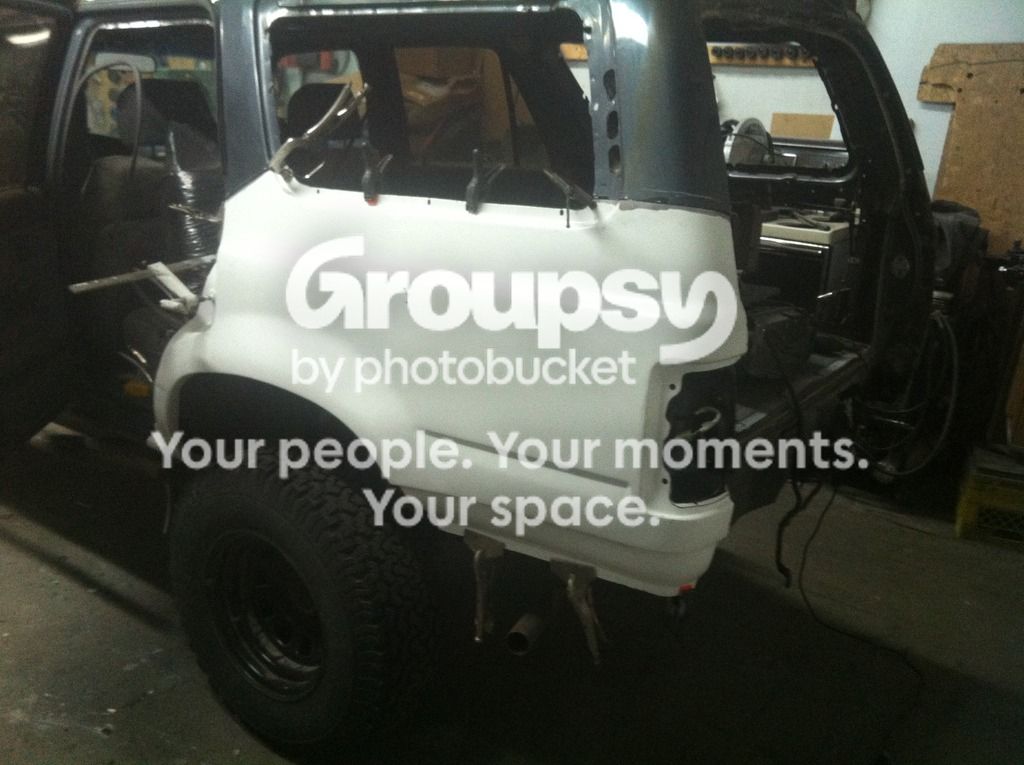

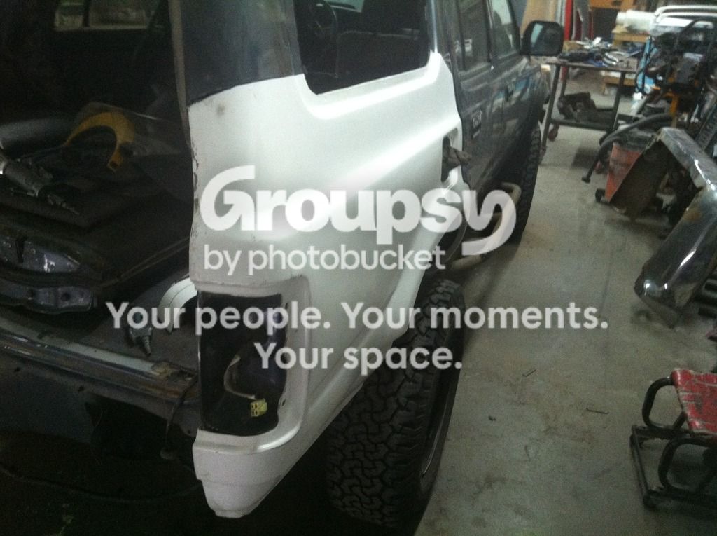

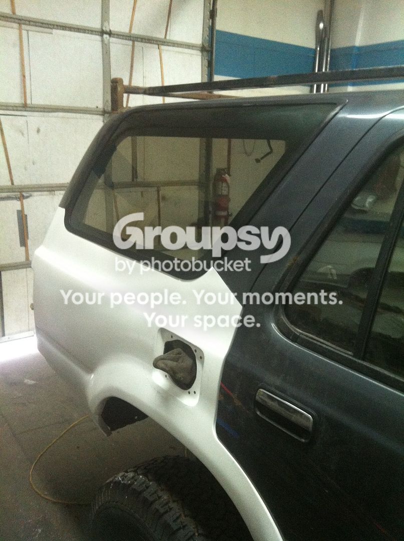

time for some test fitting
take your time .. this will take some time .. I'm about 3 hours total fitting and removing , a little trim here and there , off and on about 10 times , but you want to do this to fit them correctly
IMG_0118_zps3llmdj6a.jpg~original
IMG_0117_zpstgdkba9n.jpg~original
IMG_0124_zpskm8mgxav.jpg~original
IMG_0125_zps2k1evnjc.jpg~original
and now I'm happy with the fit ... time to fit the window
IMG_0126_zpswatxledd.jpg~original
and happy with this ... I can now move on the the rust repair

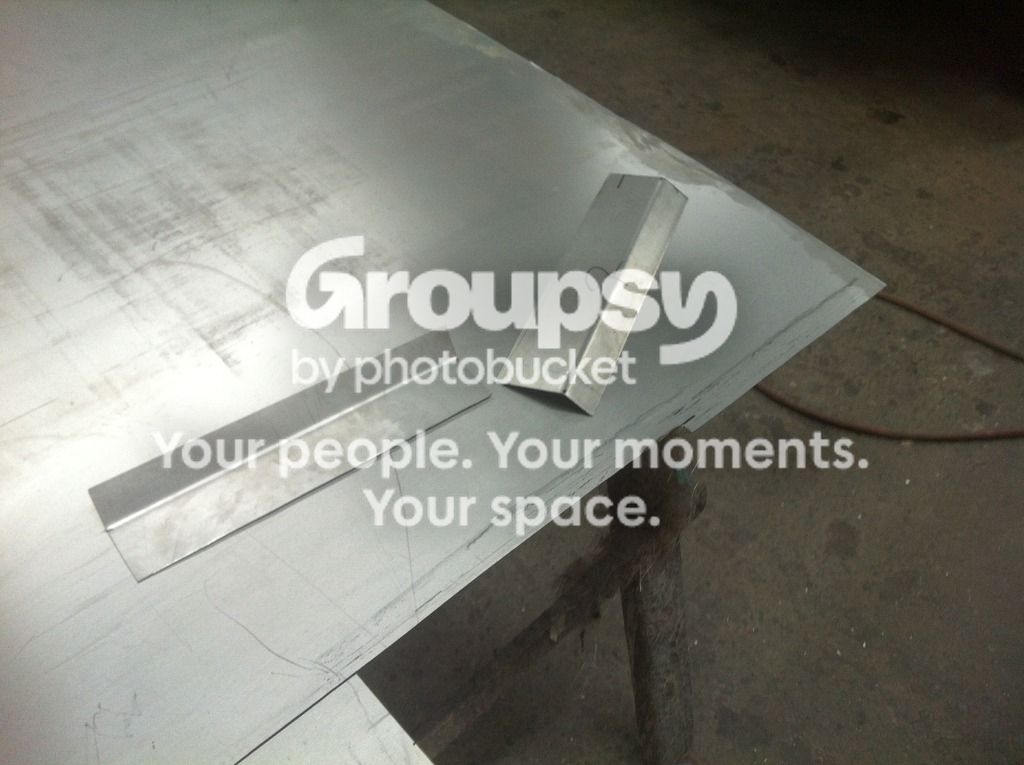

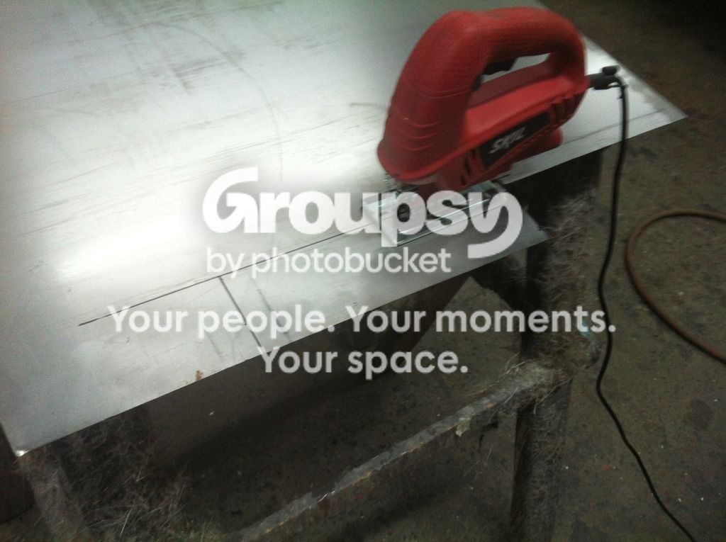

first I took a couple of measurements of the piece I would need to cut out . then got my sheet metal , drew the lines , and cut it out .. jig saw works great for these small pieces .
IMG_0135_zpsa1ugkgj9.jpg~original

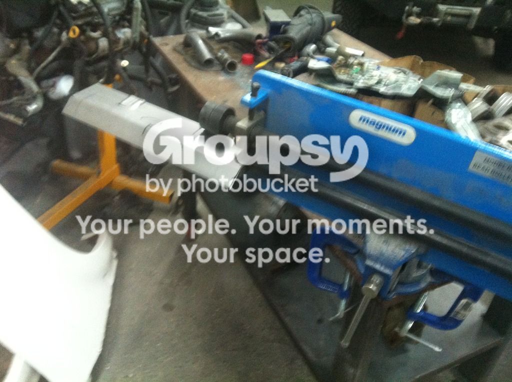

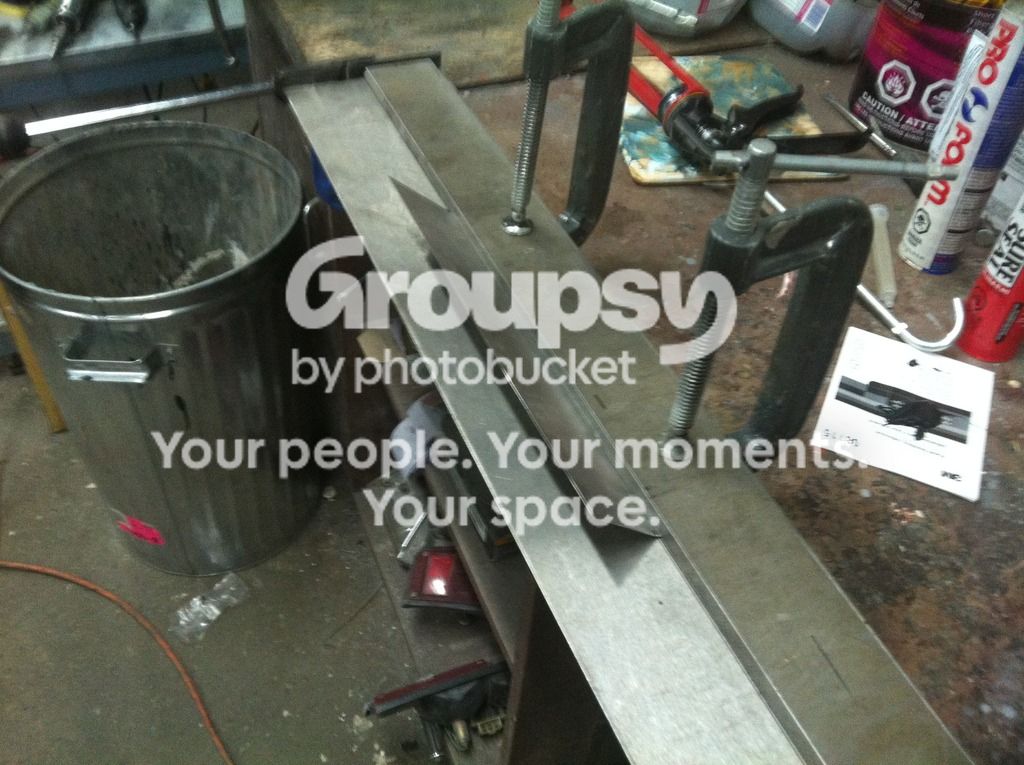

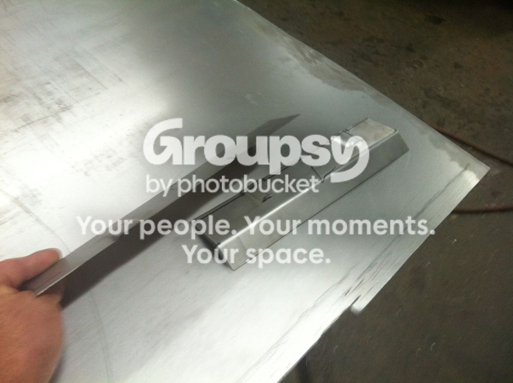

Then with the mini bender , you can put an edge on it .. a piece of 2X4 it counter edge will work as well
IMG_0136_zpsuklzi0hh.jpg~original
IMG_0137_zps2zjzxlwe.jpg~original

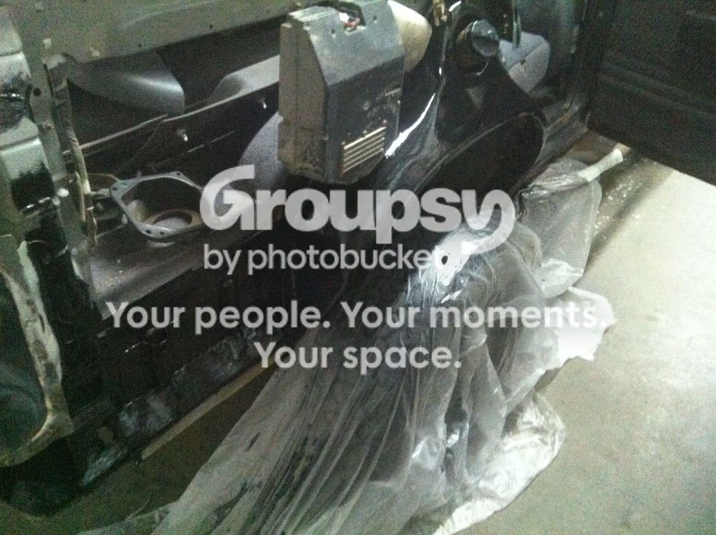

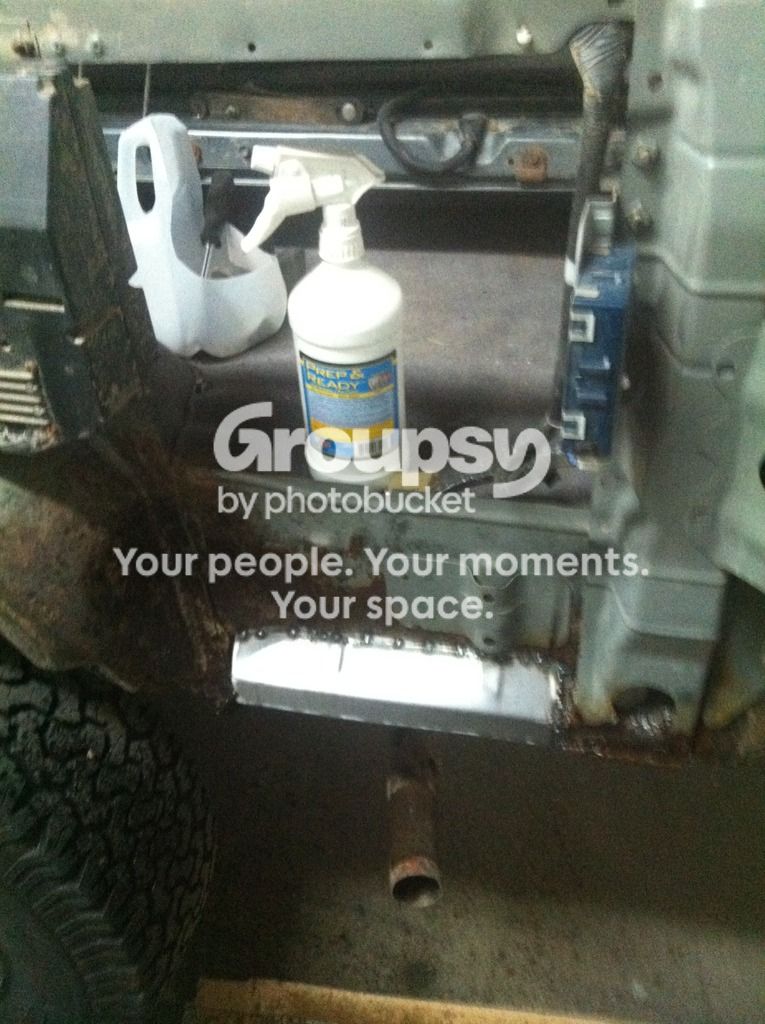

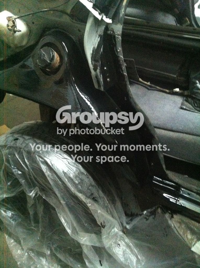

and now tacked in place I can now prep for the POR15 treatment
IMG_0146_zpsmgztvbwf.jpg~original
POR15 done .. to cure overnight
IMG_0149_zpsfe2cq1ah.jpg~original
IMG_0148_zpsblr0jhb9.jpg~original

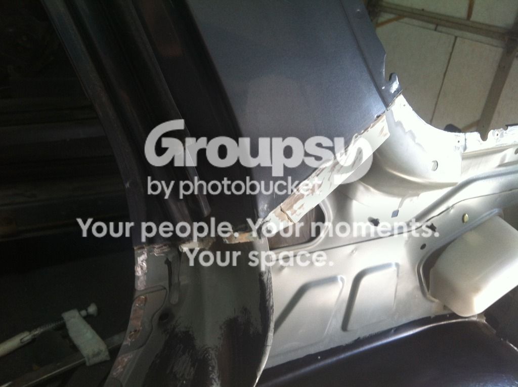

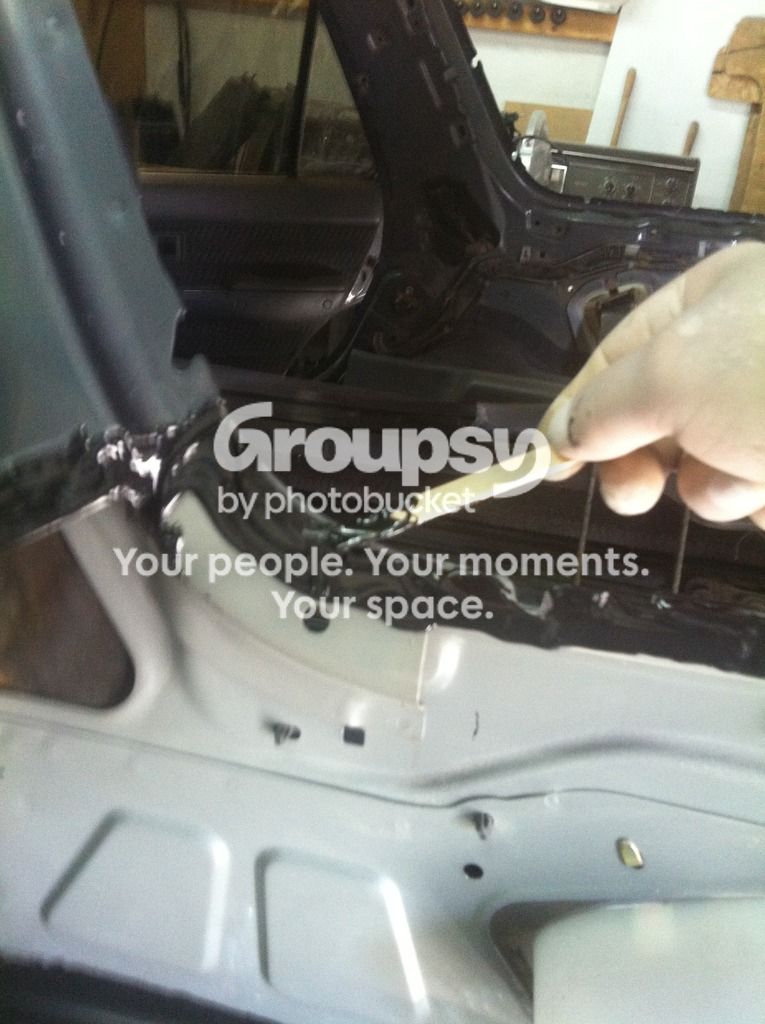

so with the long weekend over , and everything cured , time to make the sides permanent .

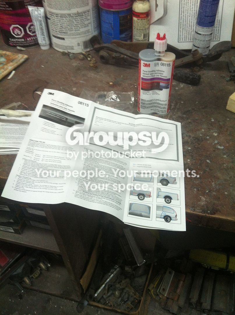

We use in our shop , and recommend 3M panel bonder #08115 . not cheep , but in my opinion , it is the best + it is the only product that offers a lifetime warrantee
IMG_0169_zpsfzesvnay.jpg~original
be very liberal with it .. I use a popsicle stick to spread it out , and make sure I cover all bare metal
IMG_0172_zpsqrh533vp.jpg~original
installed and clamped

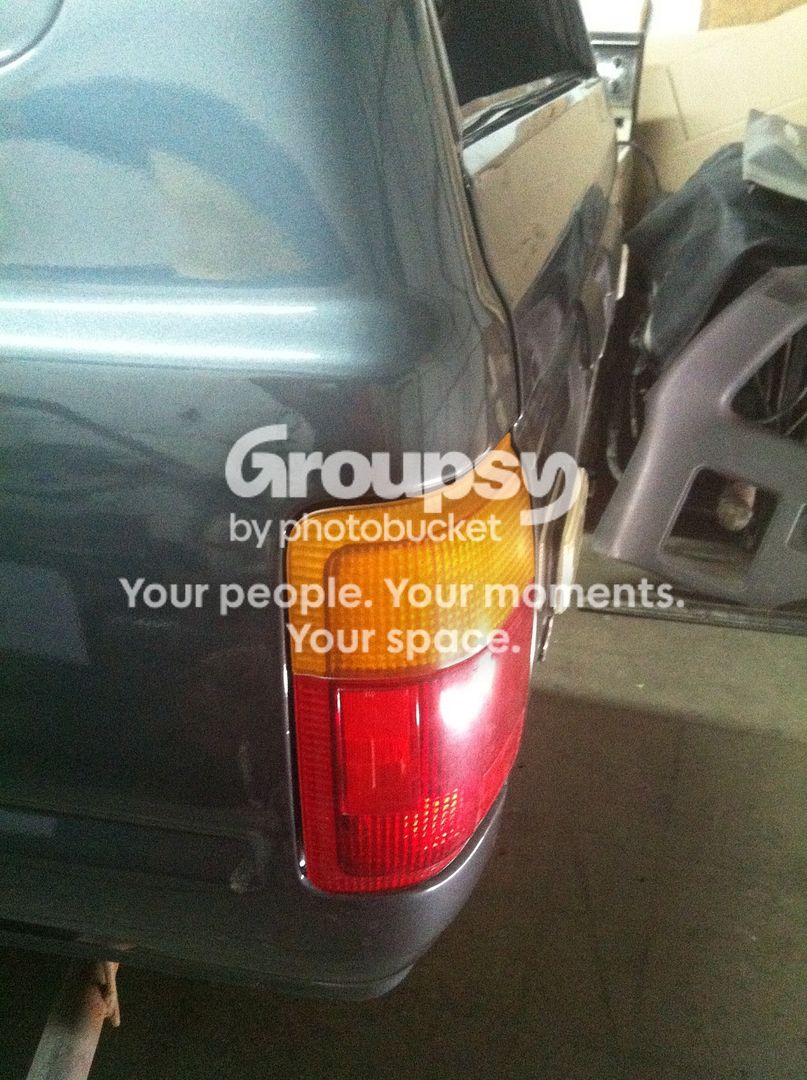

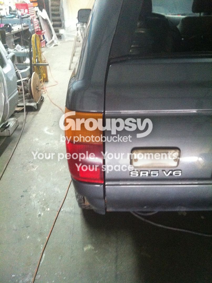

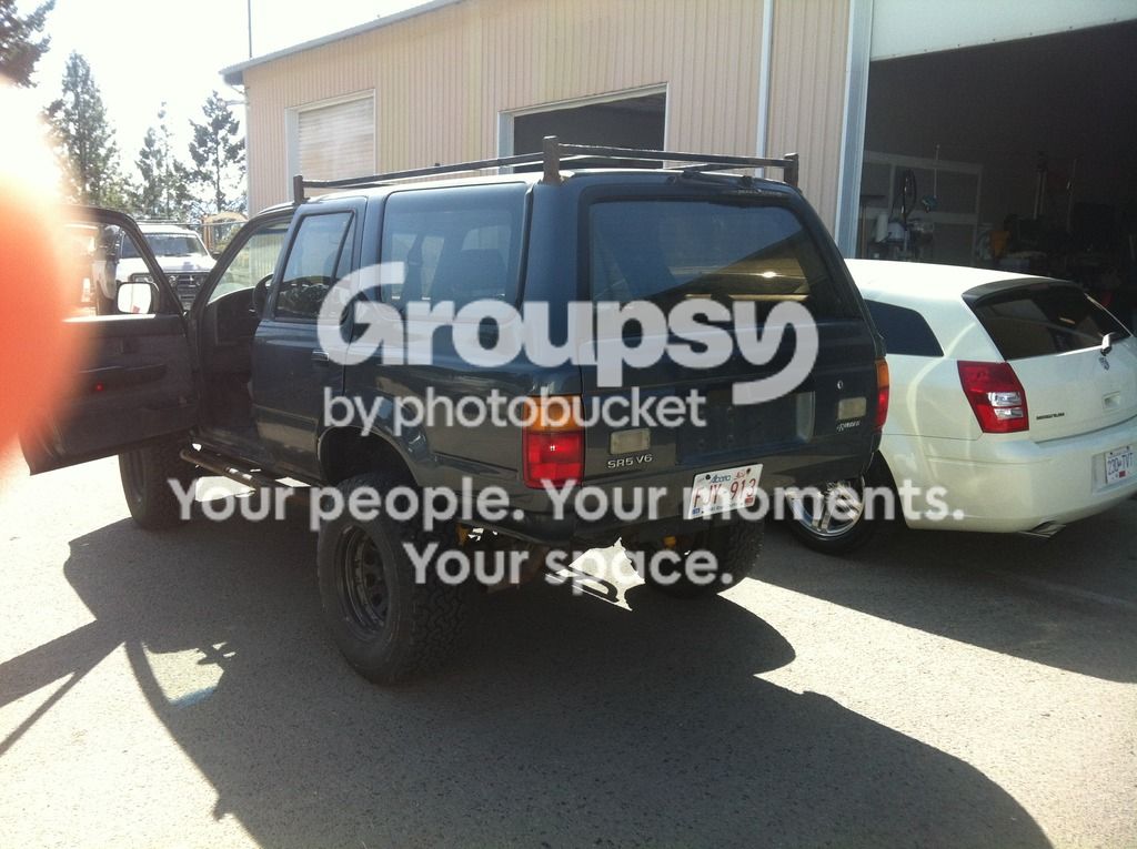

all done , Customer has picked up , paid , and even booked an appointment for next year , for more stuff .. maybe even a 3.4L engine swap ...
enjoy the pics :)
