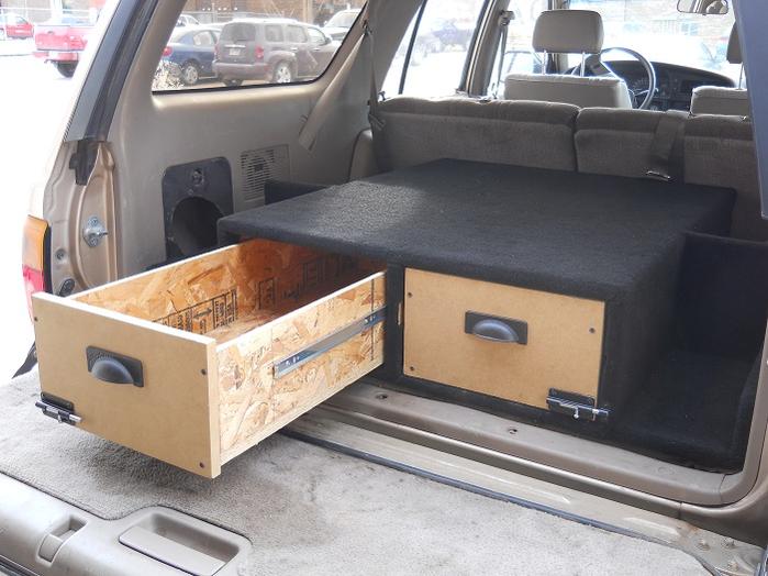

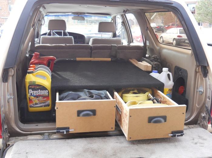

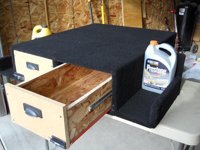

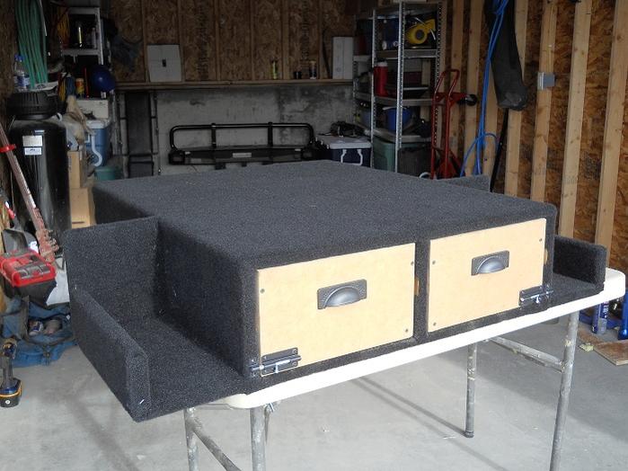

Finally finished my storage box for stowing gear in the back of my '95 Runner. Not too bad for someone with absolutely no training in carpentry work or cabinetry--I like it, anyway. I've made a few stereo boxes and mounting boards before, but nothing with sliding drawers (no, they didn't work well on the first try, either--had to redo it--LOL). I think I'm going to get some brackets to mount a shovel, Maglite, etc. on top, and maybe some D-rings on the corners for a cargo net. Those are 100# slides on the drawers, so they should hold plenty. If anyone asks, no, I'm not looking to make any more--LOL!

Thanks for the kind remarks! Islander, it's not bolted down just yet--haven't had it in the rig but a couple days. The thing is very heavy as is, and can't move unless I roll, but I will probably tie it into the factory cargo tie-downs. To combatmedic, it would've taken a couple weeks if I worked on it steady (I work on stuff like this VERY casually, just piddling along), but I stopped working on it a few times and got side-tracked. If I was serious, I'm sure it could be done in a couple afternoons. The slides are what messed me up the most--I thought I had the measurements down good, with everything checking squared, but when I tried to put the first drawer in, it was about 1/4" off at one end. I ended up having to break both side walls loose, put the drawers in place, and make new screw holes about 1/8 to 1/4" further in--the "joys" of not really knowing what you're doing (LOL)! Anyway, they work great now.
