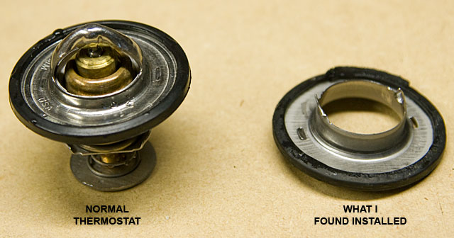

I just did a little reading on this subject (probably should have done that before posting, oops). It sounds like my thermostat maybe stuck open & that's causing the engine to take longer than it should to get up to temp. I'm going to replace the thermostat & see if that helps.
Well apparently I was kinda right. My thermostat was indeed stuck open. VERY OPEN...
Apparently the PO felt this was the best fix for an overheating issue. Please don't do this sorta thing people!
Anyway I installed a working thermostat & now my overdrive kicks in shortly after starting the truck. No more waiting 20 minutes or longer. Should save me a bunch at the pump. What I've yet to see is if the PO's overheating issue returns. Fingers crossed.
