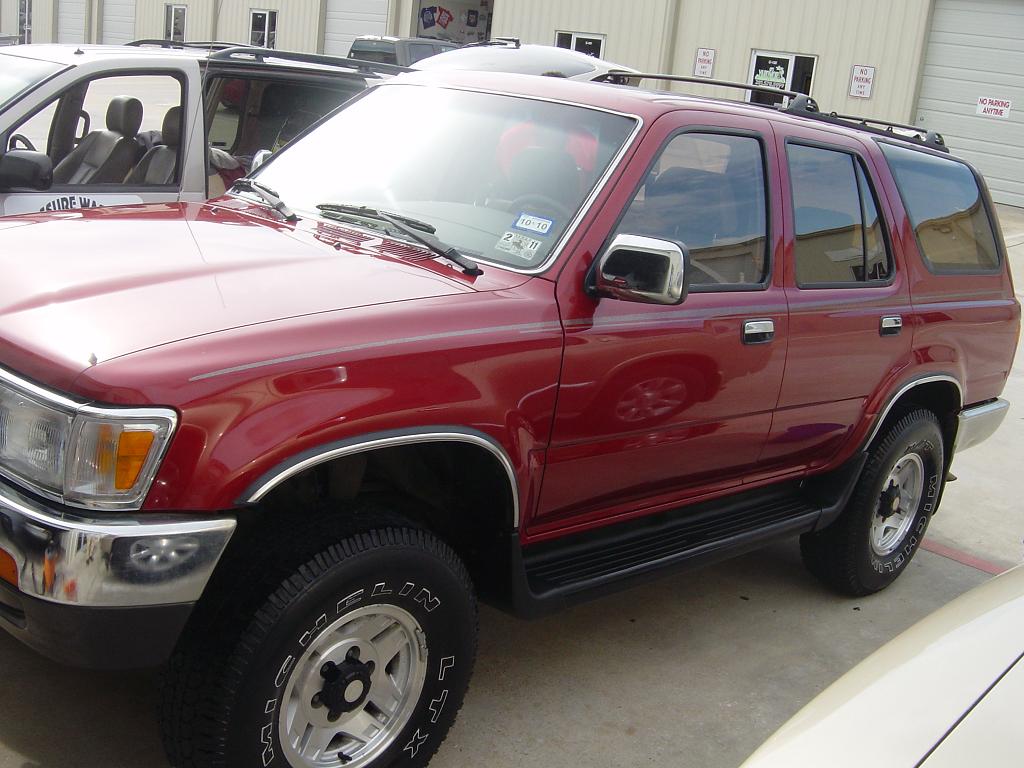

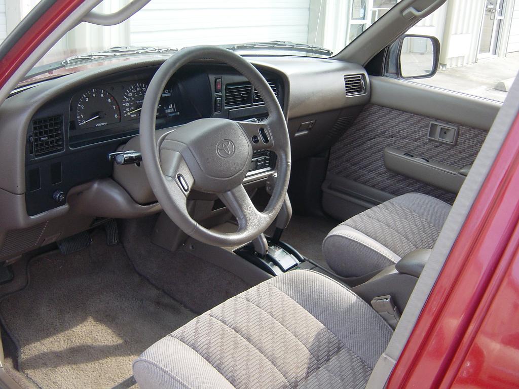

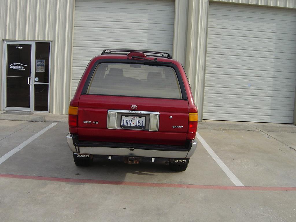

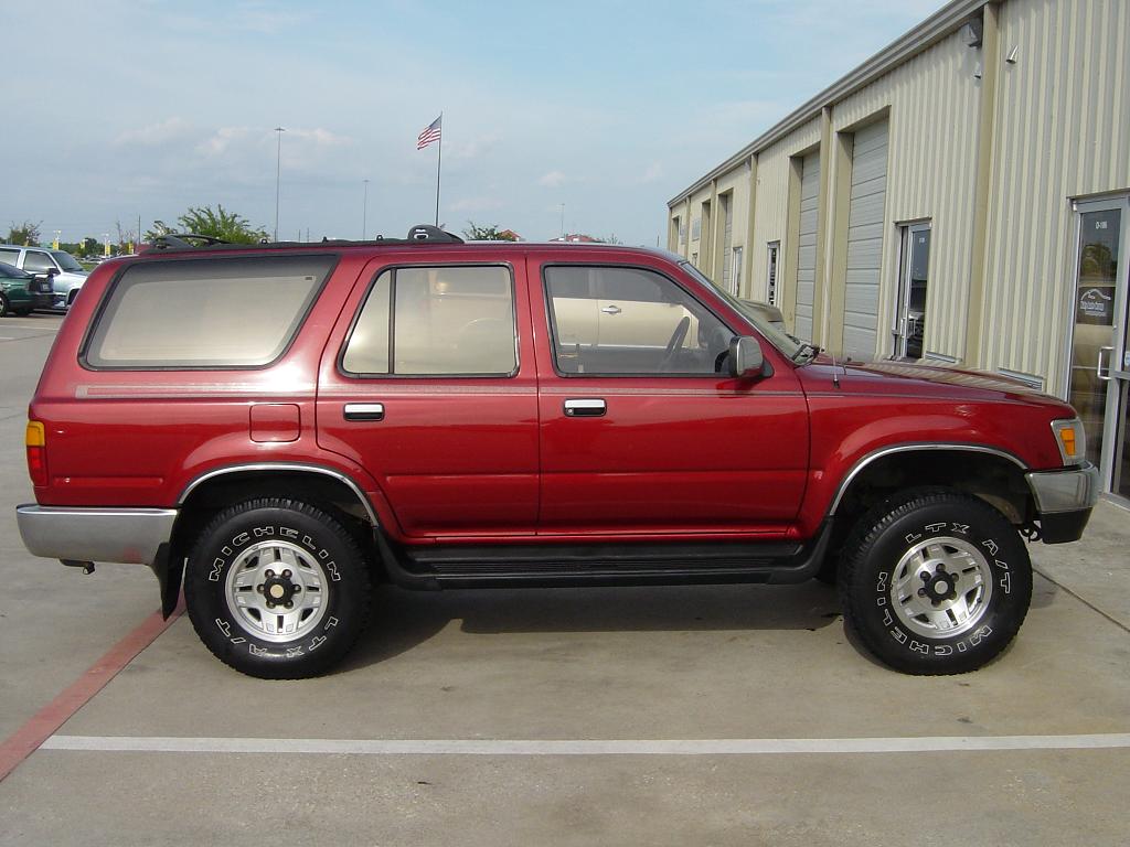

I picked up my '95 4X4 yesterday...I'm pretty happy with the purchase. I got the head gasket fixed and it ran great on my 100 mile trip back home. My wife has a 4th gen. and I used to have a 3rd gen...seems like this 2nd gen sits up a lot higer than the other two...I like it though!
