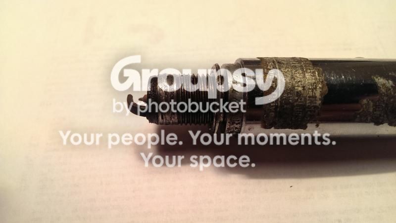

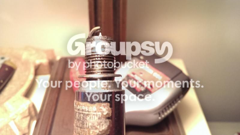

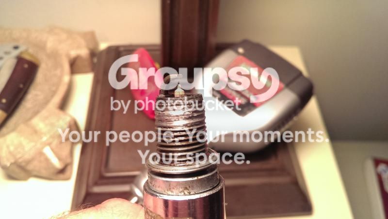

So I've had a 2nd gen for a couple of months, has run fine up until it started rough idling about a week ago. I through some seafoam in the brake booster hose, the crank case and the gas tank. Three days later, I was on E, drained the oil, put in fresh oil and started changing the spark plugs. All of the plugs came out just fine with the exception of #6. It was stuck solid and it took me probably 4 hours of slight movements and PB Blaster to get it out. Well wouldn't you know it, when the damn thing came out it looked like this:

Am I royally screwed?? Or is this salvageable (by me). I've sunk quite a bit of cash in to this damn truck already and I really can't afford to take it off and have it redone by a shop. Hell, I'm in Central Kentucky if anyone is around that knows what to do, I'll buy you a case of beer! Any suggestions are welcome. You're my only home T4R!
Tap the threads, this should fix the problem. 20 dollar fix if you ask me(get quality taps not cheap crap). Be careful cause you don't want to break the tap in there. So go slow with it.
95Newb
The quick fix is to tap the threads. Use lots and lots of grease and go very slow, you don't want to drop any shavings into the cylinder if you can help it. Putting the cylinder at TDC will help you see if you dropped any metal in, assuming you can get an angle to look in.
The right fix is to helicoil the head. That's not something I'd want to try with the head on the block and in the truck, you're much more likely to leave behind shavings and debris.
you can Heli-Coil wile in the truck with a kit ...... (just have to get the correct size, use lots of grease. I even make an adaptor out of small poly hose to fit a shop vac & stick it down the cylinder to suck out any thing that may have gotten off the grease )
read this..... may help........
3vze spark plug thread repair
One get new ****ing NGk v- power plugs not platinums like what's in the picture. Get a m14x1.25 tap I believe(don't quote me) put it on tdc for that piston get a magnet with bendy handle and go over it a few times with the tap then get the magnet out it through the hole and get as much metal as possible repeat last step multiple times until you get little to nothing. Thread new NGk v-power gapped to spec in hole and connect wire and hope and pray your spark plug doesn't come flying out
Hate to be so Blatant, But your advice is Wrong. The Head is made of ALUMINUM, & is not magnetic! ( not like a early US Cast Iron motor.) So if he uses your advice he wont get any of the metal shavings out. (Ive been working on cars all my life. Also worked with metal for well over 20 years...)
I have had to Heli-Coil several heads in my life, drilled & taped oil passages in blocks, etc. & I used the the same method with 100% success. That said, there are a few different styles of tap tool kits for doing a spark plug hole, but the grease method works with all of them.
& If you don't feel the grease is enough protection & want to be even more cautious, you can drill a hole in a shop-vac attachment, tape the end shut & insert the tap through it (if there is enough room to fit the attachment) so it will constantly be sucking out any metal fragments that come loose from the grease.......(if you do it correctly, there shouldn't be anything that comes off it.
From here on out, always use a dab Anti-Seize on your spark plugs. (a little bit goes a long way) I also use it on exhaust bolts/nuts & lug nuts. Also be sure you dont over tighten the plugs. (thats a common mistake.)
depending on if there are any threads left, im guessing there aren't, since its the end of the plug that's stripped. if there enough threads, you can just run a tap through it, if not, it will need a thread kit installed.
whichever you end up doing, dip the drill bit/tap into grease each time, go slow, and back it out and clean it often.
its fine if some very tiny bits of aluminum end up in the cylinder, they will melt/burn up.
regarding the anti-seize, im pretty sure I read something recently(on here) that NGK specifically says do NOT use anti-seize on their plugs. it can alter the friction point and cause the plugs to get over-tightened.
Thanks for the tips all. After inspecting I opted to get a thread insert (Time-sert) put in by a mechanic buddy of mine. Thankfully, all went off without incident and only cost $100. Runs like a dream now!
