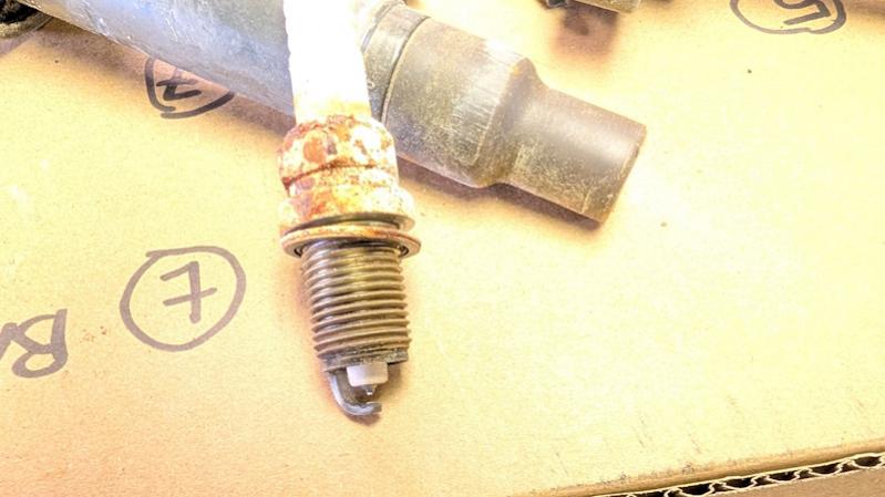

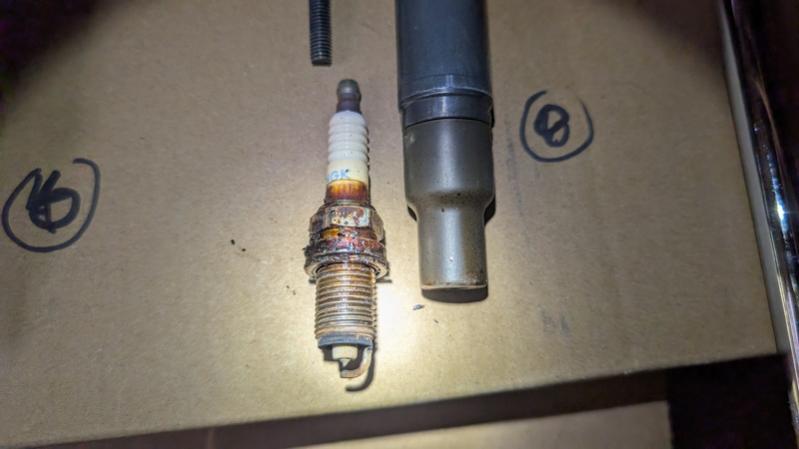

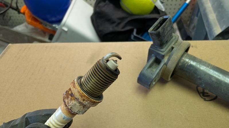

I vowed to do simple maintenance on my new (to me 4Runner) after the accident, and so I decided to clean the MAF, Throttle body, and check up on the spark plugs to see whether I could get a little better MPG or tackle the gassy smell.
The spark plugs all looked normal except for Cylinder #7 and #8, as pictured. Any ideas as to what could be the cause of these?
I went ahead and cleaned them with a brass brush, and ordered some NGK 4589 and will be replacing them next weekend.

The plug insulator looks a little white but not too bad but that does sometimes indicates water in the combustion chamber which could explain the "white smoke", also the rust/corrosion on the body of the plug would concern me as to how water would get in there to corrode it, maybe the previous owner used a pressure washer to clean the engine and forced water in pass the coils.
Do the rest of the plugs have the same rust or just those 2, is the rust what you're referring to as "fouled"?
The 2 plugs shown were the only dirty ones, all others had no grime or rust on them.
We'll see whether the dirty spark plugs return after I swap them out and drive a bit.
I did take the car for a wash once I returned from purchasing it, and I do spray the underside. The previous owner was a surveyer, so he probably drove on forestry roads and such, so there was lots of dirt clumped on the underside. Even then, I live on the rustbelt, so the roads are salted during the winter, hence the good spray underneath. I couldn't see any water getting up to the sparkplug boots from my actions though.
You didn't answer if the rust is what you're calling "fouled"?

This sounds like a blown head gasket to me, especially if those plugs have a white residue on them. How about the oil filler cap? Is there a white/milkshake residue there?
If it has a blown head gasket/s for the 2 plugs shown it would be both heads which is very rare, that is if the 2 plugs shown indeed came out of #7 & #8 cylinders, which are on opposite banks of the V8.
What would you attribute the white smoke to? 10 minutes of white smoke is quite a lot and I agree that blowing both gaskets is rare but something serious has impacted both of those plugs and only those plugs; strange.
Can't say without him doing some further troubleshooting, at this point I would check #7 & #8 cylinders with a bore scope after sitting overnight to see if any coolant is sitting on top of the pistons, also checking the coolant for the presence of exhaust gas.

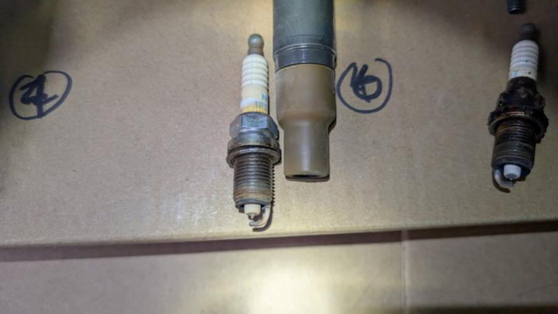

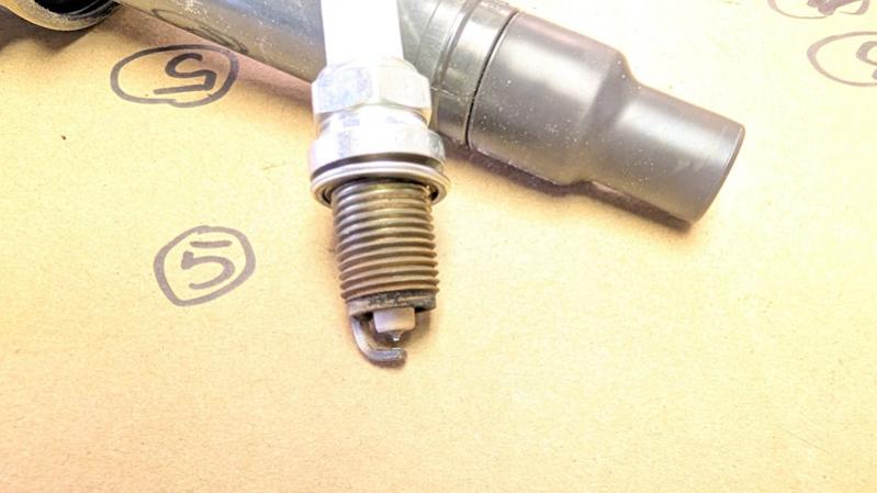

I can't really judge the comparative condition of the 2 plugs he has shown without seeing all the other plugs!
He also says they're "fouled", I don't see where those 2 plugs are fouled at all, all I see is the rust on the upper part of the plugs which won't affect them firing properly, looking at them they appear to have been firing just fine.
Apologies if 'fouled' was the wrong term to use here, but yes, that's what I meant on the dirty plugs.
Engine runs fine, no hesitations, nice and smooth, no coolant depletions, and gas mileage only slightly less per tank than my former V6 (approx. 420~460km @ 1/4 tank). The V8 getting around 400km by the 1/4 tank mark.
Oil fill cap does not have any froth, and an coolant tester is next on the docket.
Gah, I'm getting anxious at the thought of another head gasket job.

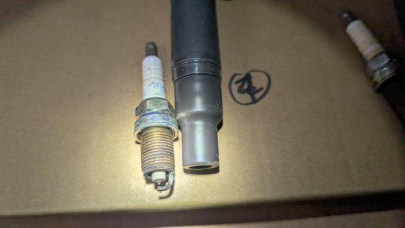

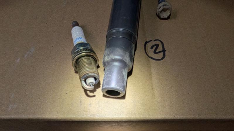

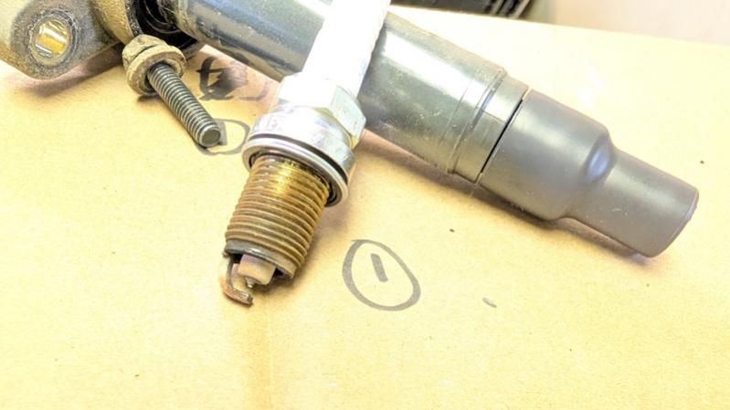

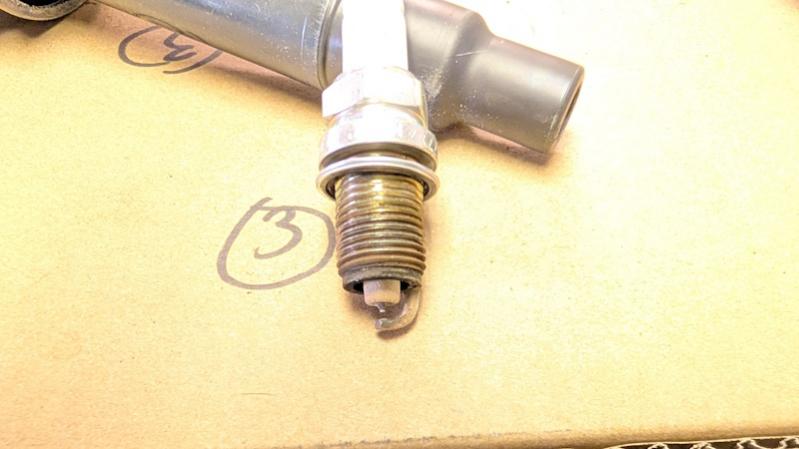

I agree on replacing the plugs. You didn't get a maintenance doc from the previous owner and those look old, even if they aren't. I don't know why #7 & #8 are rusted like that unless there was a hose leak spraying water on them. (I had that happen on an Olds, where the hose for the heater core sprang a leak and was spraying my distributor, causing it to run extremely rough.)
The white smoke for 10 minutes would be a worry for me, but if there's no residue in the tailpipe then maybe it's just condensation burning off. Replacing the spark plugs and checking them again, say 500 miles, might tell you more.
