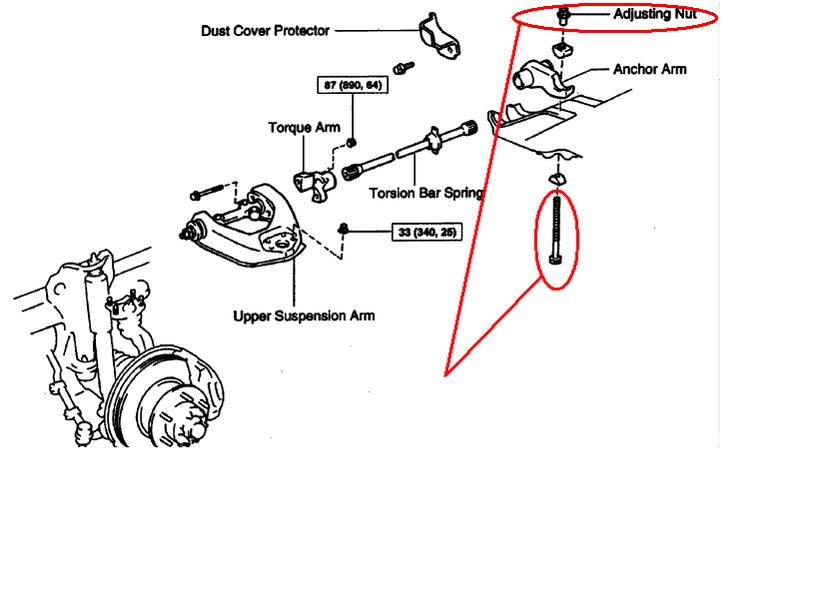

About the bolts and nut you recommend me to change where are they located in this Diagram?

Here is the FSM diagram for the torsion bars and a jpeg file

thnks for the info purevenom ...i will order them...another question ... besides suspension components on kit (coil spring,shocks, tbars,and sterring damper) what other suspension components will you guys advice me to change ? ooh i changed recently pitman arm and indler arm...thanx for the assistance!
