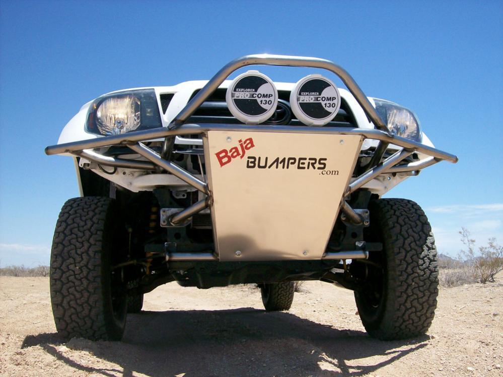

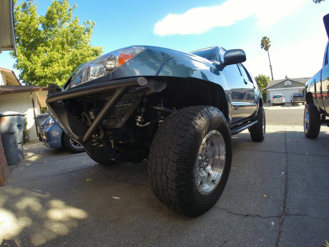

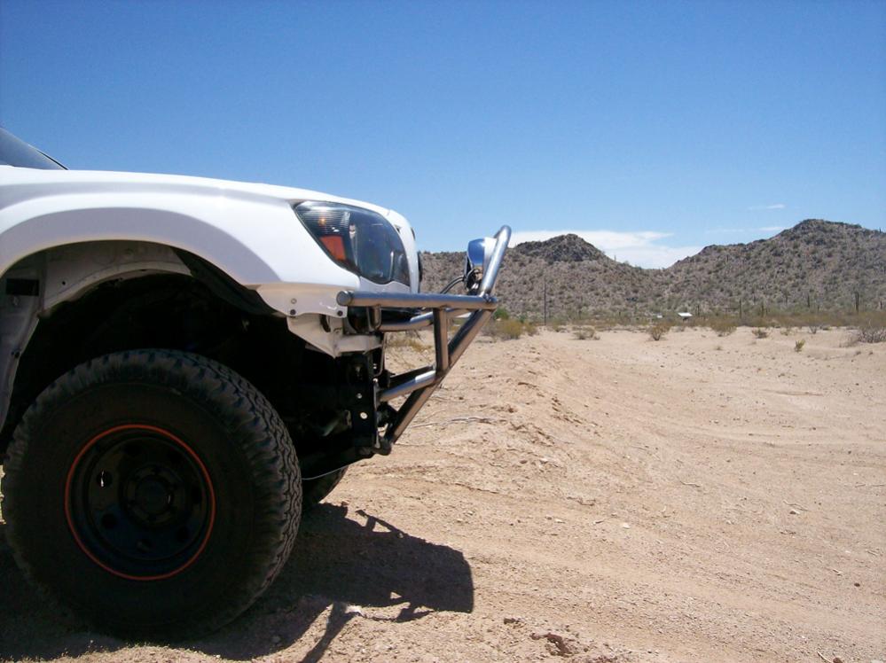

4Runner Bumper Props: designed and built by [MENTION=95421]Troymclure[/MENTION] for [MENTION=87687]LTDSC[/MENTION]. Unfortunately, I think Jake (Troymclure) has a full time gig, so only a few members were lucky enough to have one built. And I live 3k miles too far away damn it. FYI, Baja Bumpers (Tacoma pic) closed up shop several years ago.
EDIT: Just looked at The Skid Kid on IG. Correct me if I'm wrong but isn't there a 3rd gen Taco headlight and grill on a 4th gen 4Runner? He does some SICK SHIT by the way. Already subscribed.

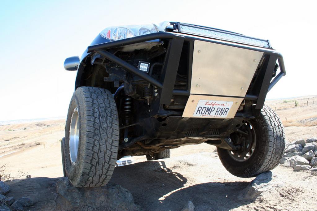

toy_yoda4runner on IG runs a taco bumper on his 03, there was another guy too I cant find. I know the 07 grille bumps down lower than the headlight fillers so anything straight across on the top would require cutting grille short.
