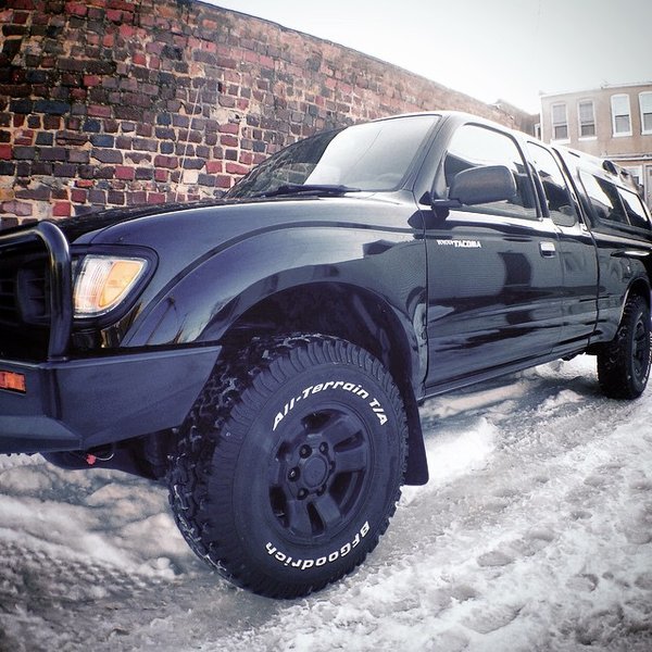

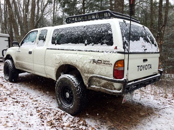

My Tacoma

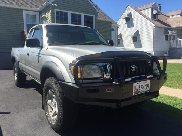

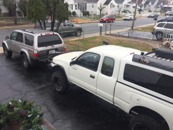

My dads 2004 Tacoma, welded the rot on his frame and I did the Arb for him:

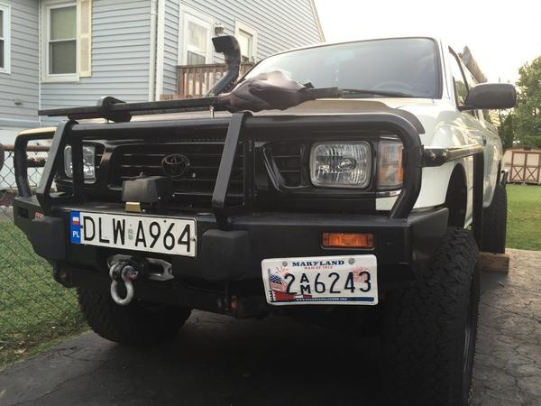

My Brothers 1997 Tacoma I also did the Arb for his:

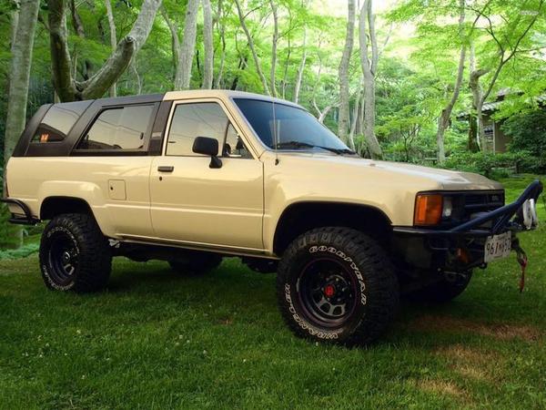

And his 87 4Runner he painted in our backyard:
2stroketrush-albums-my+t4r-picture43204-11665545-10100350020578416-6743957523123815385-n-2.jpg

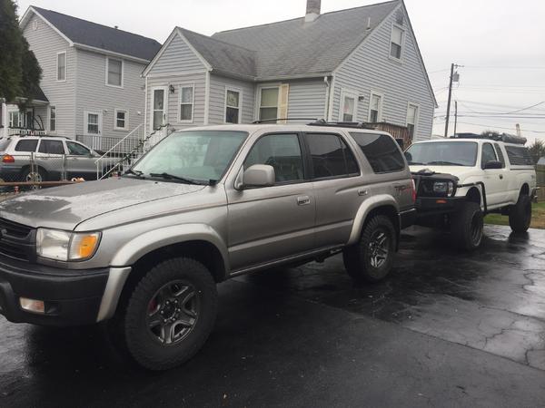

Then one day about 2 months ago one of my good friends asked me to come take a look at the frame on his wifes 3rd Gen 4Runner. I deemed his frame unrepairable and he got rid of it, but before he did I got a chance to check it out, thats when I realized I had never been in a 3rd Gen and I loved it. Kind of like the best of both worlds. I new I had to get myself one. I started looking and sold my daily driver, a 2001 Honda civic that gave me 35 MPG. Then yesterday I found my new to me 4Runner.....

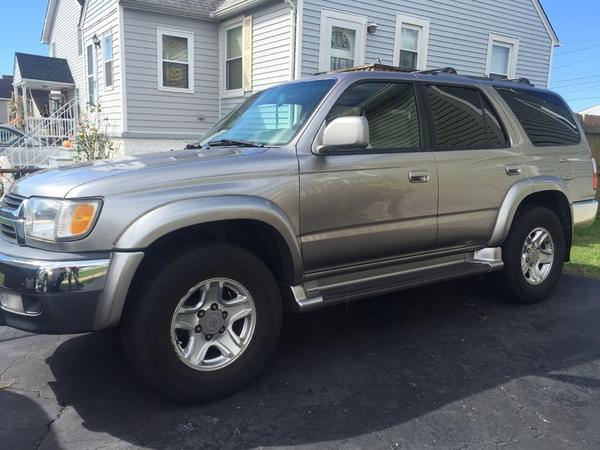

Found her through a friend of a friend and settled the deal for 1500$ 2001 V6 4x4 Sr5 with 200K miles and in decent shape. Hoping I did well. Sorry I don't have to many pictures yet, basically haven't had time to even touch it yet, I will soon, Crazy couple of days...

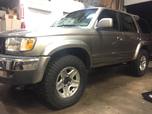

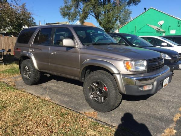

New Tires! Went with a set of Falken AT3s All Terrains and got a smoking deal from discount tire direct. They ride great and look awesome. Just wish they would have come with White Letters.

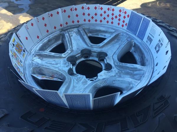

Spent most of yesterday doing lots of painting on the 4Runner. Started with the wheels, I had never painted rims before and I think they turned out pretty good. I had to remove LOTS of flakes and oxidation in the rims and doing so I went to deep in a few spots and you can tell. But Ill get over it. Used VHT Wheel Paint primer, paint, and gloss. Degreased and cleaned before hand and let 30 minutes between coats in the sun.

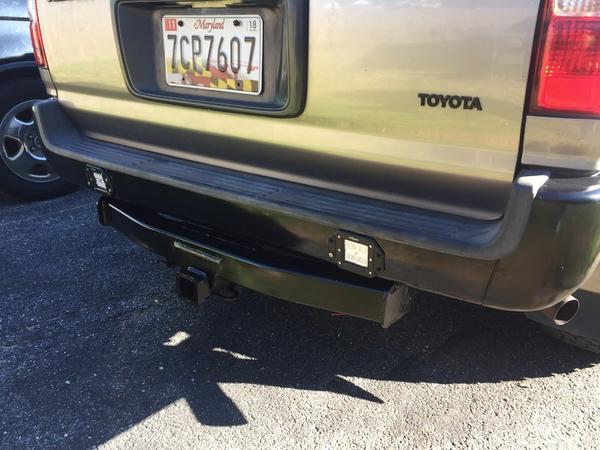

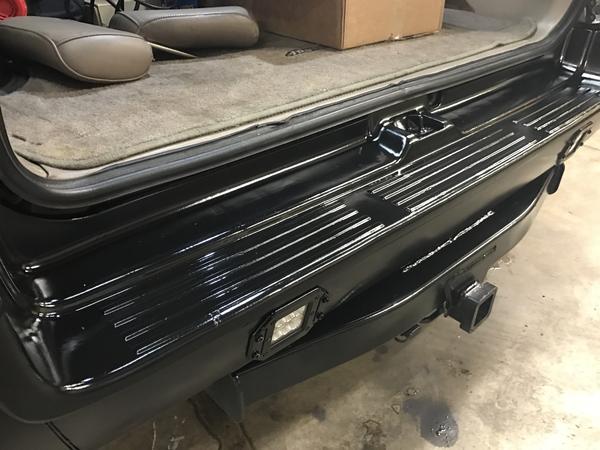

Then went to change my rear bumper over from the rusted original to the nicer one I found last week. But the mounts where different, so I had to modify and weld The old mounts to the new bumper and it ended up working. What made me more mad was when I went to install I see there are some offset holes that may have worked! I assume Toyota changed the mounts but not the body for these few years. Also Cut and installed some flush mounted LED's for backing up and light at night. Ill wire them to a switch on the dash somewhere.Cleaned up the rusted hitch while I was in there and painted the bumper but it didnt turn out as nice as I would have liked.
Not really much happening recently I have been busy building a motor for my boat so it doesnt carry over into the winter. Still working on the 4Runner though. This week I converted the interior dash lighting to LED and I love it. Half of my climate controls and right hand buttons were out anyway. Pretty easy to do, just a little time consuming.
Also wired up the rear LEd's but I dont have a picture, simple wiring with a red light rocker switch in a factory blank. Looks good.

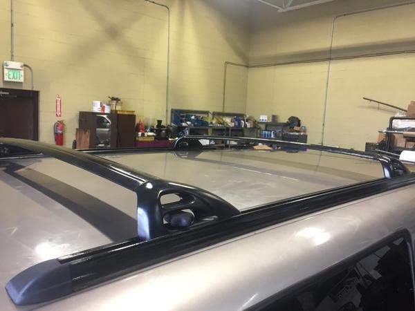

Removed and painted the roof rack since it was so chipped and faded:

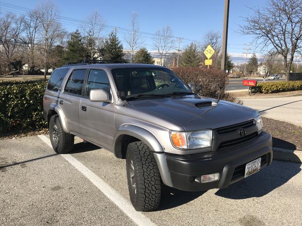

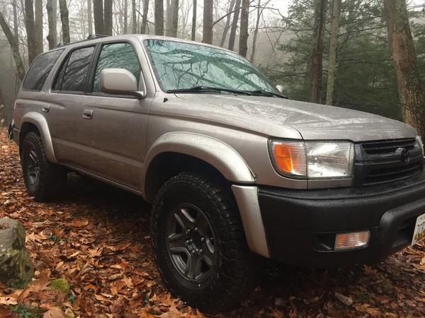

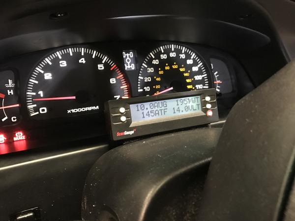

Just got back from my 300 mile trip and the truck did great, I averaged 22mpg with engine temps never getting above 198 and trans temps jumping between 150 and 190 degrees. Cant complain there:

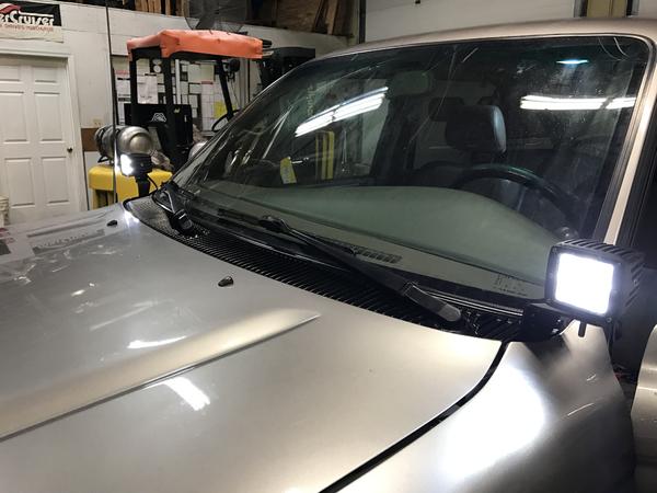

Installed some CBI Ditch Light Brackets in anticipation for my christmas present from my Grandparents which is a set of LED square pods with a spot beam. Should look really good.

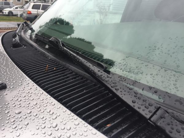

Painted my windshield wipers since they were really faded and chipping like every other sun faded black piece was. little changes make the difference. lol

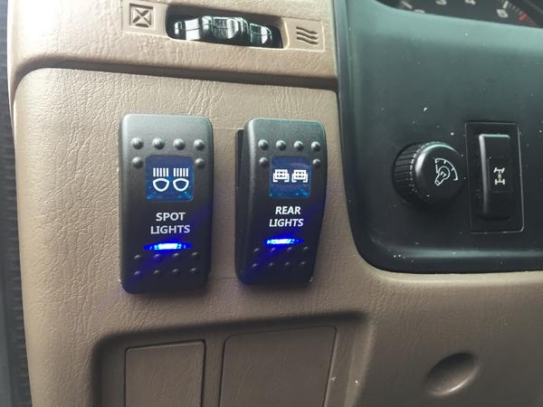

wasn't a fan of the switch I had installed for my rear LEDs so I ordered these two with labeled rockers and always illuminated bottom light. Pre-wired everything for the Ditch Lights to.

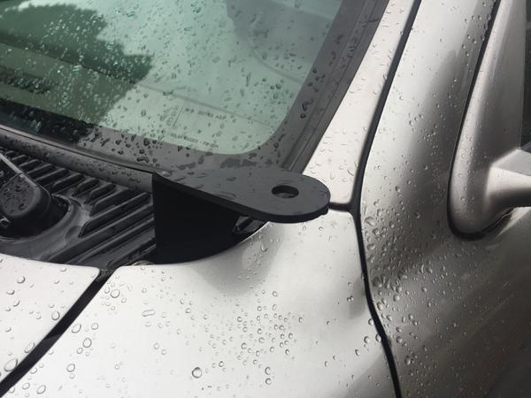

Installed the LED pods on the CBI Ditch Light brackets and wired them up. Ran the wire under the windshield bracket and I painted it while I had it off. Used a black plastic paint and it worked out great.

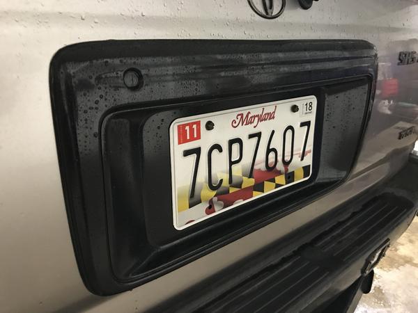

Also painted the plate bracket as it was faded from the sun.

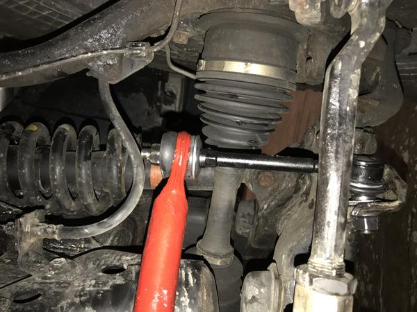

Replaced the end links and sway bar frame bushings, Painted the sway bar red just because.

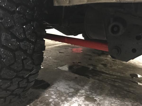

And painted the rear track bar red, kind of sets it off.

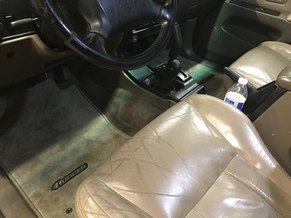

Then finally got around to detailing the interior and pulled the seats out to work on the carpet, Got them pretty clean, but some of the stains were pretty rough.
[/IMG]
Everything back together with a new set of 4RUNNER floor mats

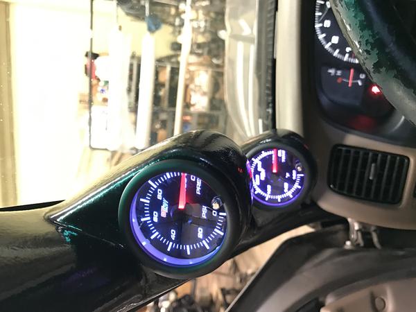

Then I came across a friend selling a gauge pod holder off his Tacoma and I grabbed it from him for Super Cheap, I painted it and moulded it to fit a 4runner. Ordered a set of Glowshift gauges that read Oil Pressure and Oil Temp. IN the picture they look more Blue-ish, but they are actually white and match my LED Converted dash quite well.
Had to move my Scangauge here to make room for the Gauges and turn the brightness down because it reflected on the windshield at night. really don't mind it here, I thought I wouldn't like it at all but it doesn't block much of the view.

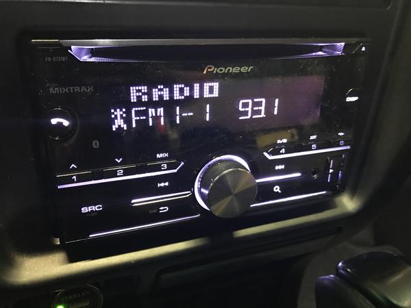

Lastly installed my new HeadUnit I got for Christmas. Nothing special just a double dinn Pioneer. I really do like the BlueTooth phone connect feature and the fact that you can change the color of the entire unit. Of course to match the rest I chose White.

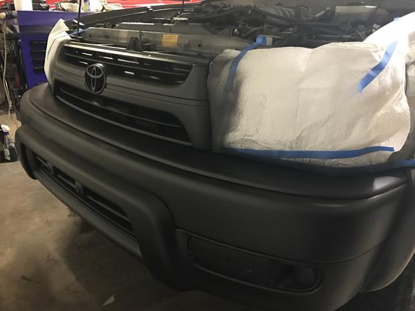

Front bumper and grille re-PlastiDipped, first coat wasnt thick enough..

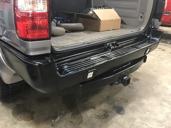

Rear bumper lightly resprayed, and the faded plastic step-cover-trim thing got painted as well. Much better

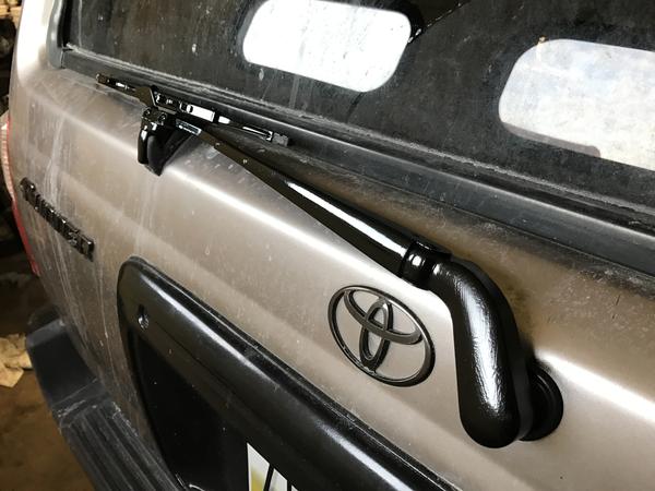

Rear wiper painted

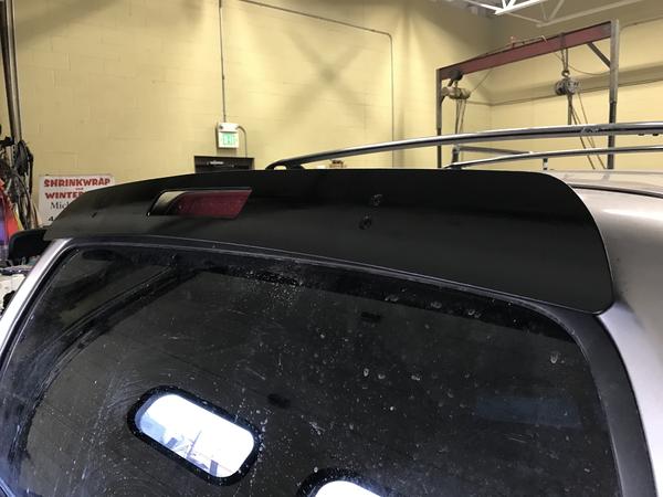

Spoiler painted

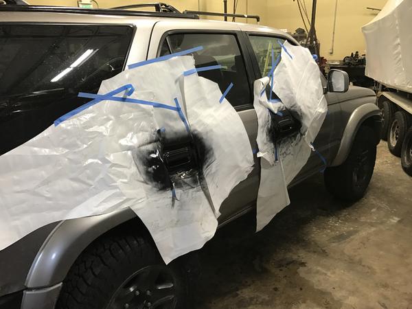

Door handles painted

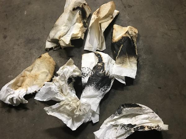

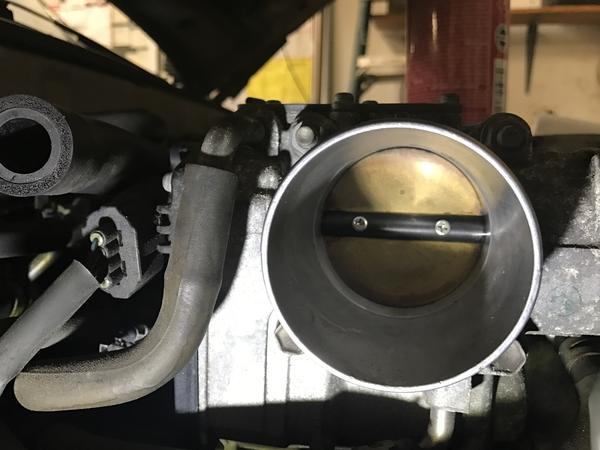

Throttle Body cleaned, All that on the rags came out of it. Throttle response is sooner and she seems to start easier.

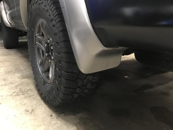

Rear lower mudflap delete.
