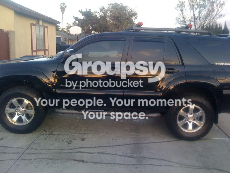

Does anyone have pictures with this combination? Or maybe a 265/70/17 tire? Or 255/75/17? Thanks. Just trying to decide whether to do the 3/2 or the 2/1.
3/2 cornfed w/285/70r/17
3/2 cornfed with 285/70r/17
I have the 2/1 lift with 265/70/17 tires, so if you find a 3/2 with those size tires you can compare them to see which one will better suit you. If you go with the 3/2 I recommend a bigger tire than 265/70/17's though. Otherwise it's similar to a 2/1 lift with stock tires.
