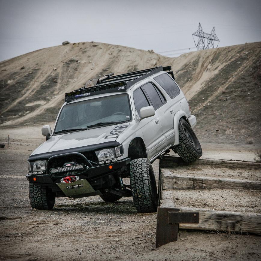

Here's a picture I grabbed a little while back!
(In the picture I was running Tundra Bilstien 5100s but I have switched to 2.5x8" Coilovers with Reservoirs now.)

without giving away state secrets...how do you get long travel with no CV mods?
other kits require longer CVs
Yes this uses 1st gen tundra cv axles, it is a direct fit and they are 3.5” longer so they are perfect for this length of long travel!
Interesting. Most LT kits are way out of my budget, but I could probably borrow a TIG welder long enough to make these.
How to these compare engineering-wise to other LT kits? Would there be any differences in caster/camber/toe? Will these hold up (especially with the BJs and heims) to being on a DD?
