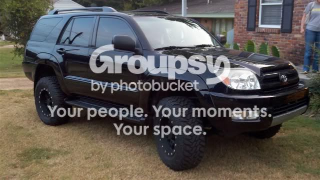

4runnerLift.jpg~original
does the pic of the black one have the 3" spacers and 1.5" body?
Thanks crimson, ive got 265 now, i would think i could put 275 w/o any mods right?
YES, the black truck is a 3" with a 1.5" body (maybe a 1" body lift).
