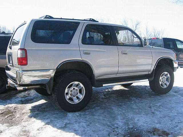

it's a bad pic but mine is the one on the LEFT, went from 265/75 to stock 265/70 looks much better more fender clearance

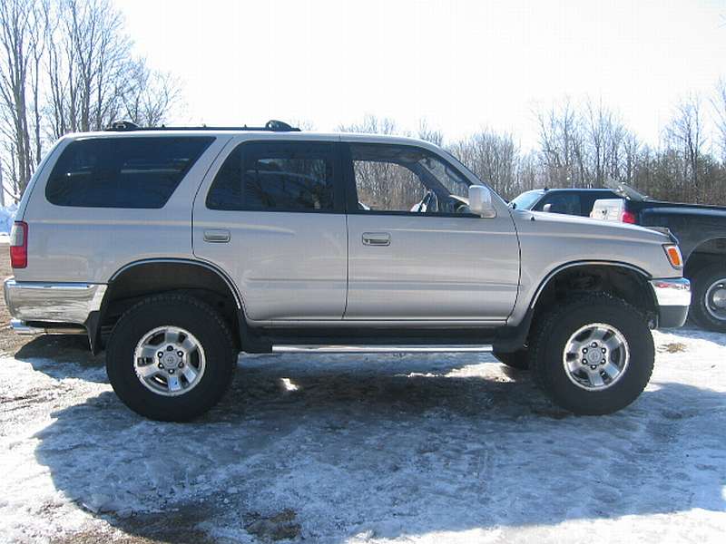

I got that lift put on last night. It took 2 sets of compressors, some wrenches, air compressor, impact wrench, and a 2x4board to get them in place. But it looks and rides great. Thanks for the info.

Post some pictures !!
