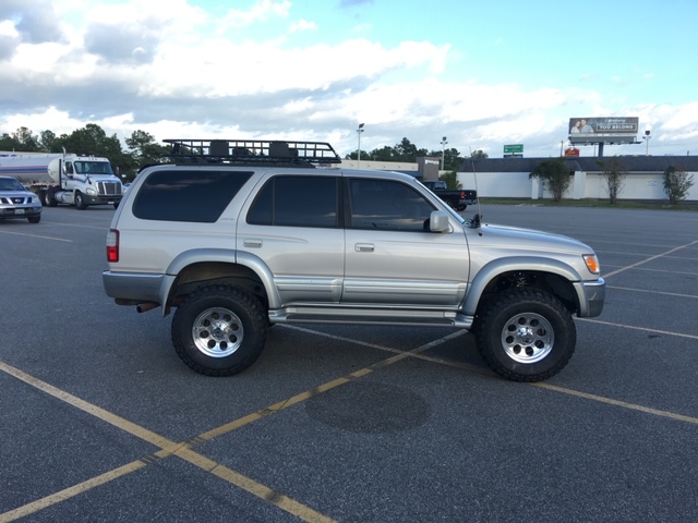

1st: I put the TTboss9602 Boss suspension system on my 96 runner with 600LB red coils on front with 4x4 drop diff kit and 3" toytec coils boss rear shocks but i need to know best and easiest way to get front end level with back? will post pics

What are yoir measuremets front and back. Truck looks pretty good with a slight rake. The rear might settle by 1/4 inch. ttboss 9602 are adjustable from 2"-3" if you are at max height then there are no other real options other then strut spacers but It will be difficult to get one less then an inch or a whole new front setup.

haven't done measurement yet bc i wanted to see where it would be sitting after driving it for a while to get them. with the blocks for the front end are they pretty reliable? also if has a decent amount of sway and i wanted to know what i could do about that as well. i haven't messed with any of that stuff yet?
Looks good to me.. If it really bothers you I’d go with different springs in the rear instead of additional spacers in the front. Eimkeith pan hard correction kit will help a bit with the sway.
1: Best way? Add armor of sorts - plate bumper, skids, etc. Easiest way? Couple of 80lb bags of concrete from Lowes/Home Depot for like $5 each
