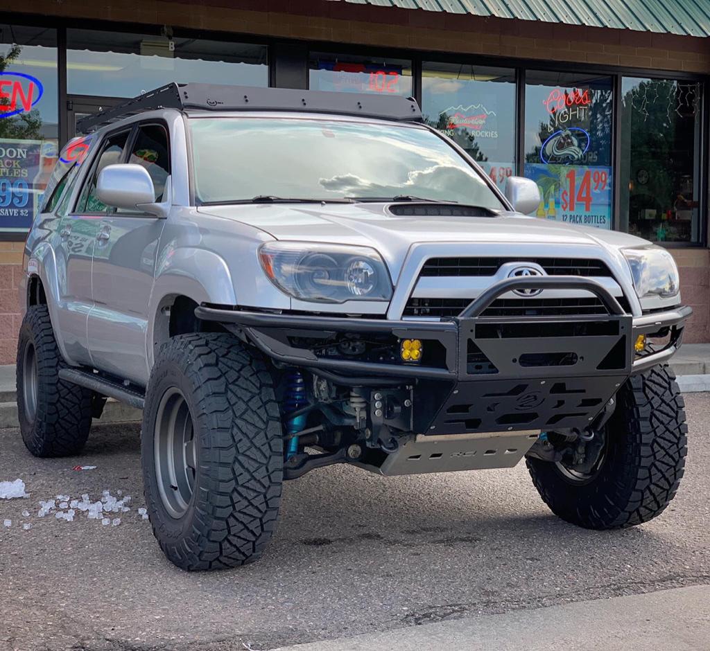

I am on a 3" lift with a 1" bodylift with lots of trimming and still have a bit of rubbing on the firewall with a 315/70/17. Can be done, and if you don't wheel hard it may work with less trimming. Wheel backspacing will play a big roll to gain some clearance. I have a lengthy build thread with the tire fitment/progress.

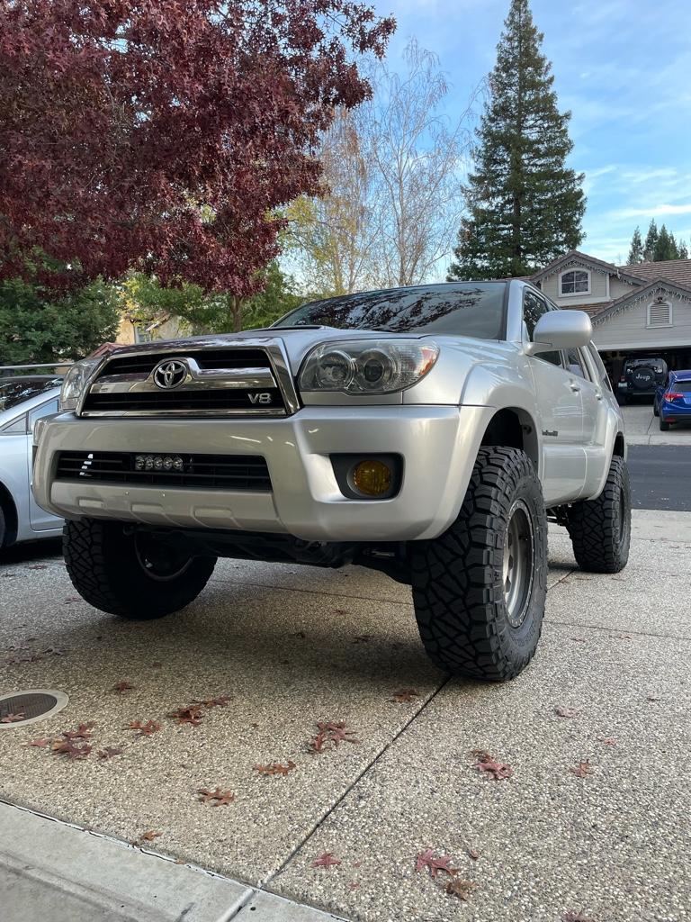

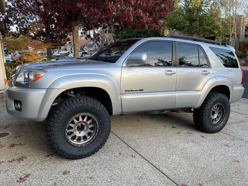

Eh ordered 305s. They’ll be fine for how much I wheel haha. 305/70r17s on this one
Pics! Not too much more trimming needed compared to the 285/70s I had before. Stoked on em! Definitely a meaty tire for the 4Runner haha
