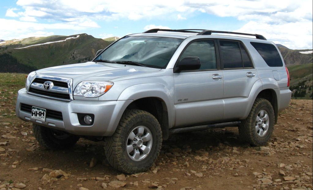

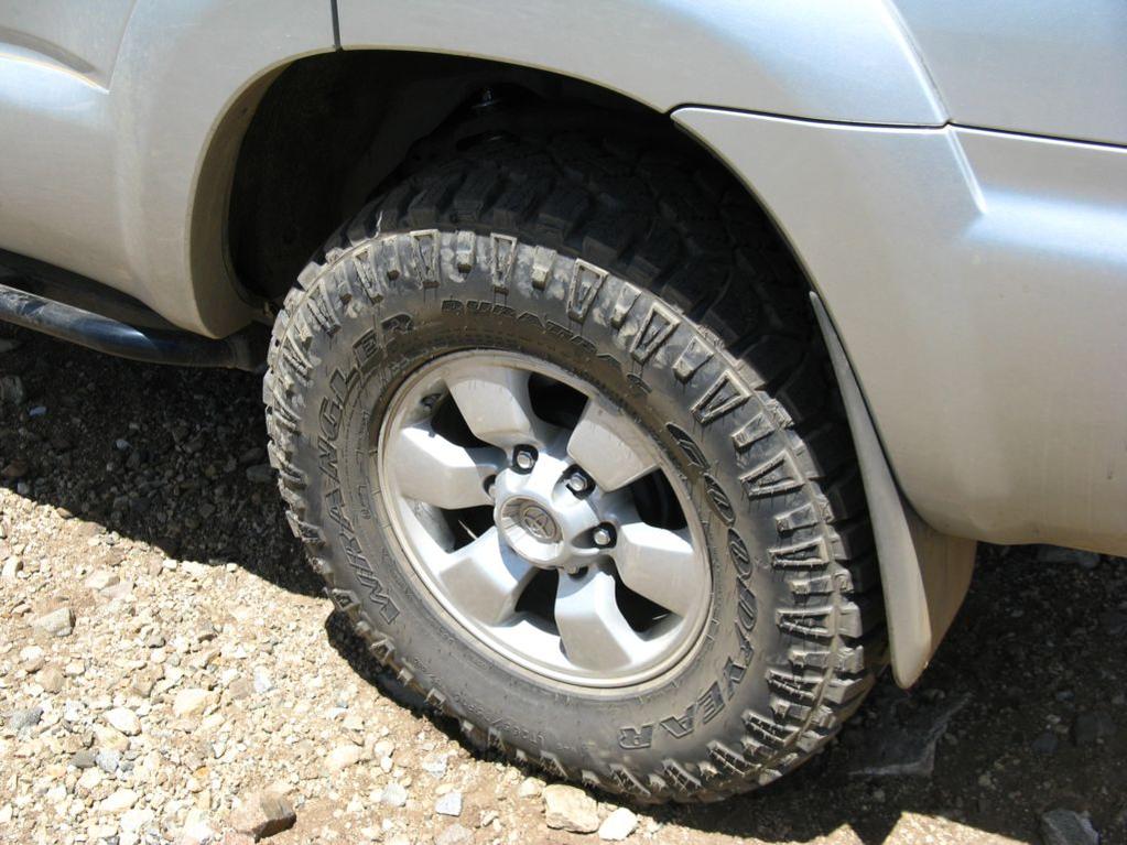

Duratracs are on
I got my lift and Duratracs put on last week, and I'm really happy with both.
I've had the Duratracs on the highway and off road in Colorado, and they have performed well. On the highway they are solid and responsive. This is not a sports car feel, but they tracked well and felt good on curves at 70 mph. While they make some noise as you speed up, it's not annoying and not much louder than the wind noise I get in my 4Runner. Aired down on the trail they performed well - on a trail that I've gotten some slippage before, I had none - they really gripped. They felt very confident and capable.
No mud or snow yet, and who knows about long term tread wear, but for now I'm happy with the purchase.
Here are some photos:
