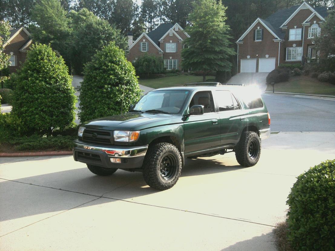

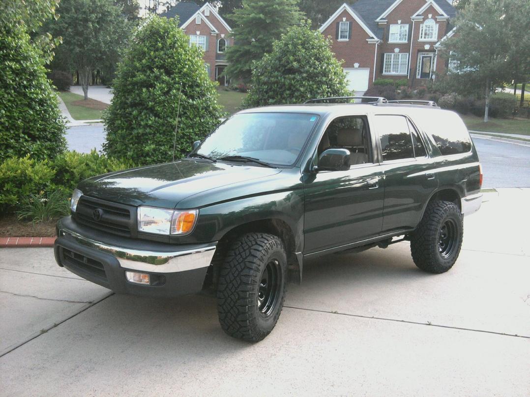

so i just test fitted the wheels and they rub on the caliper. so now i am buying a small spacer. hopefully this will fix the problem. also decided to go with the duratracs. i dont have fender flares so the 11.5 wide bfg's looked ridiculous. stuck way too far out. ill post pics later.

yea. i almost grinded down that lip on the caliper but decided that i would be better off buyin 1/4 in wheel spacers. i went with the 31 in duratracs and it looks amazing. i had to take the little mud flaps off the front bc it was rubbin. but now everything is all good. no rub anywhere.
