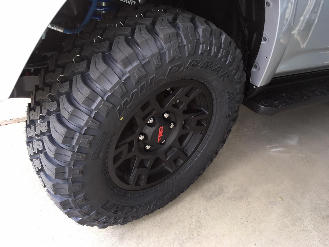

UtahSooner: do the Duratracs look "pinched" in that 7" rim?
Edit: found pics you posted thanks
