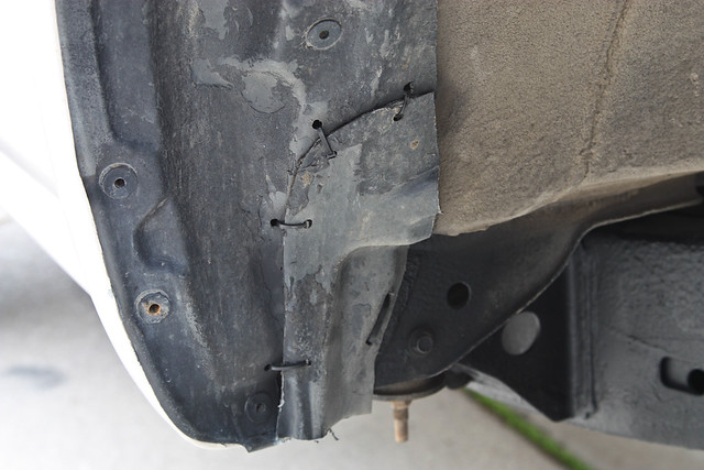

My Pinch Weld Mod

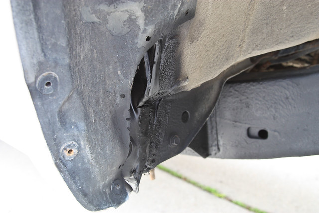

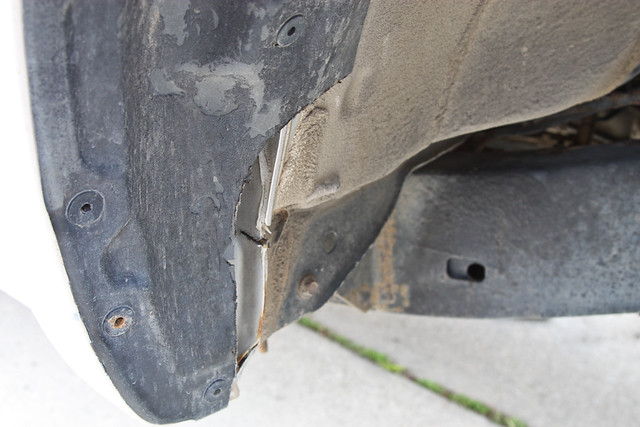

I run 32's with about 2" lift up front. I had no rub but decided to do the "pinch weld mod" anyways. I think it turned out pretty good, as I gained about .75" of clearance towards the rear of the front wheel wells, and you can barely tell I did any cutting. Check out the photos below:
- Fender liner trimmed (about 8-10" in vertical length, doesnt look like i cut that much in the pics...)
- Cut a fold line in the pinch weld with a cutting disk
- Folded pinch weld over with plyers and hammered flat with a BFH
- primed and painted
- Trimmed peice of fender liner I had previously cut out to lay "flatter" on the newly modified pinch weld
- stitched the trimmed liner piece back in place to keep mud/debris out of the fender

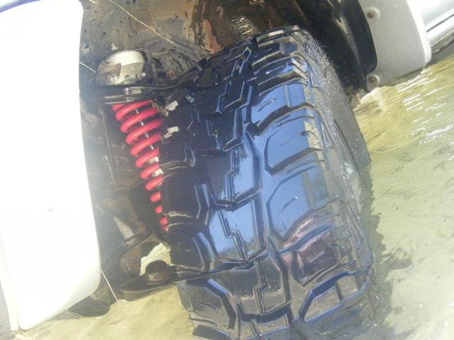

I'll be selling my Kumho KL71's in January if you wanna wait. They only have about 6K mi on em and 90% tread. They're 285/75R16s and I'll throw in my Spidertrax spacers (which you'll need with 285's and wider to keep the tires from rubbing the upper control arm). I'm going up to 35x12.5R15's when I get back. Be nice to sell my wheels,tires and spacers to compensate for the cost of the new tires. PM me
Even if you're not interested in buying mine, I'd suggest either the Kumhos or BFG KM2's. Both are good for a daily driver that likes to see serious $hit on the weekends. They do great in those GA dirt road mud holes!
