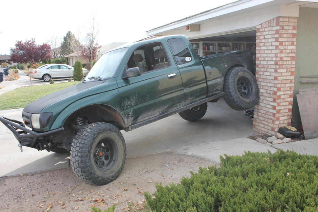

Here you go. 37's on a 1st gen with IFS.Slodgetto's Green Dragon 4x4 Conversion Build - Page 54 - Tacoma World Forums He just got them on, but it will be interesting to see how they perform.
The same guy that tested his flex by backing up onto his house.
