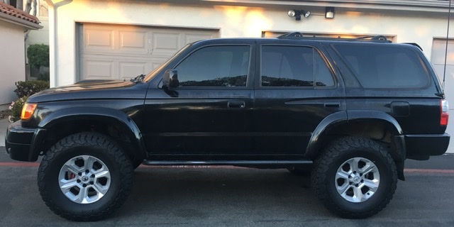

I think these are a nice option for people looking to get a large tire on a 4Runner without cutting or body lifts, and I wanted to give my review.
I picked up a set of these to replace some 285/75R16 Milestar Patagonia MTs. They measure out at 0.6" taller on my 4Runner. No, they do not measure a true 34", but no tire measures true to label size, and most fall short of spec sheet size under DIY measurements.
They are noticeably taller than any 285/75R16, including the Patagonia MT, which is known for running large.
Pros:
  • A bit taller and wider than 255/85R16s
  • Narrow enough to run stock offset
  • Load range D (not E) and light-ish at 55lbs
  • Ultra quiet, great balance
Cons
  • Price. This is a big con: I picked mine up on sale for $1300 for a set of 5, but they seem to have gotten even more expensive.
  • Must run 17s
I've been running them for about 6 months, and I have cycled the suspension without springs in place. I do not rub with the following relevant mods:
  • Front pinch weld hammered totally flat
  • Fender liner remolded with heat gun
  • Trimmed front bumper valence
  • Relocated washer bottle
  • SPC UCAs on 'G' setting
  • Extended-travel King coilovers (slightly longer compressed length than OEM)
  • 5.25" rear DuroBumps (already added these for LC shocks)
  • 17" Tundra wheels with the same 15mm offset as OEM 4Runner wheels
  • No wheel spacers
Any front or back shots? I'd like to see the profile on the vehicle. I like a skinny tire it just isn't to be on my 4Runner. Also not many skinny 37s. My 80s plow truck runs 235/85 which are basically a 32 x 9.25 and they rock on that thing. Look real good too.
EDIT: I guess you kinda posted a back shot. Hard to see the tire profile though. Looks good from what I can see though!
