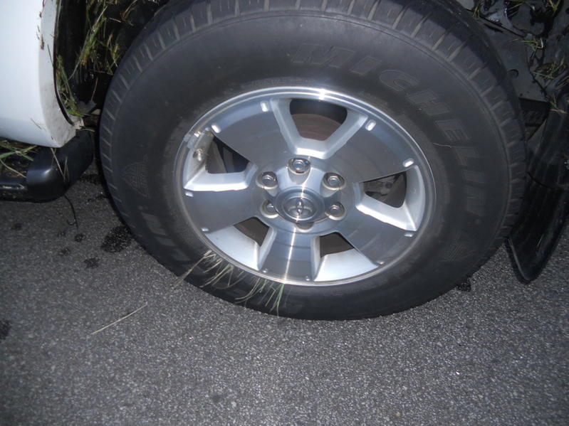

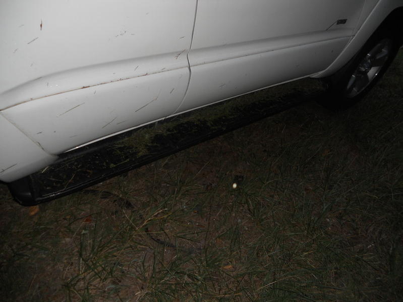

Here are some of my pictures. It doesn't look that bad, but those pieces of grass stuck in the tires show something bad happened.

Wow, glad nothing bad happened, except for minor stuff on your 4runner. Did VSC come on?? You must be hydroplanning on all your wheels for you to spin that much. Those are good tires, right? Michelin Cross Terrain??

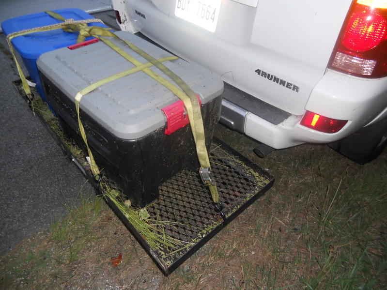

Just out of curiousity, how much weight is in those containers hanging over the back end? More than 200 lbs could certainly upset the center of gravity and make your front tires 'lighter' in a slick situation like that....I'm not implying that it may be the sole reason, but could add to a situation that is already in process of occuring.

- Your truck was likely loaded to the gills, thus necessitating the hitch carrier, both of which probably unloaded your front tires.

I know the tires were a little worn, still Discount Tires said they were OK during my last rotation
Yeah, that kind of answer makes it seem binary but, of course, it's not. Hydroplane resistance steadily erodes as tread wears away. Finally, the word "unsafe" is used where the curve has steepend and the tread is nearly gone.
Yes, the VSC came on, the whole dash lite up like a Christmas Tree. I had Cross Terrians. I bought the car used and they had one new tire because it had a accident and it was repaired. I used the spare, so I had two tires older and two a little bit newer. The last time I rotated the tires the tires with more wear were on the rear. I have read having the most worn tires on the front is better and on the rear, it is more prone to loose control if they are on the rear. Of course they were still considered OK and I rotate the tires every 6,000 miles.
When I bought new tires this week, I saved the newest tire as a spare and replaced all 4 tires with LTX's. My thinking is that they will not wear out as fast.
That is a good point. I estimate the wieght of the hitch hiker to be around 30 pounds. I had about 60 pounds or so in the boxes. It was mainly food and some fairly light material. I thought about that thing flying around on the back. I tend to tie things on tight. I would think that thing help the car spin faster.

Very glad to see that you and your family were not harmed. That is a very scary story! Kind of surprised because the cross terrains are a solid tire.
