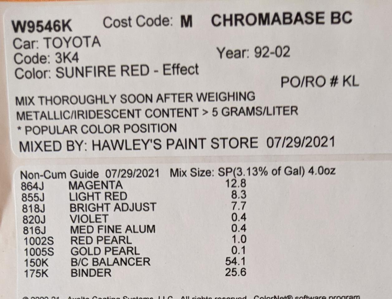

So while looking for some touchup paint, I happened upon a store that does custom mixes, and just FYI for anyone who is interested, here are the specs for the 3K4 (pic).
