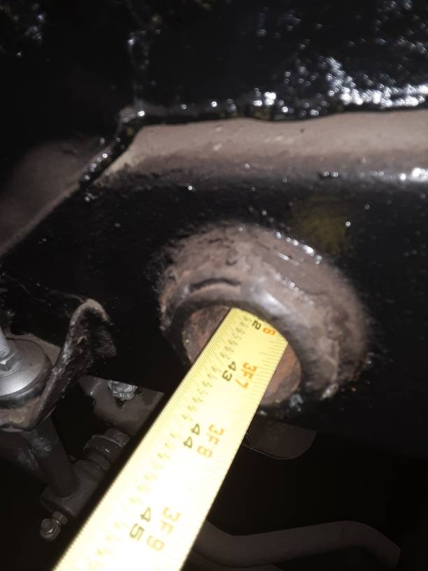

Regarding the cross member, I actually got a a heavy duty tube with the right outer diameter. I plan on welding it inside the existing cross member. I think I saw the trick on youtube somewhere. The tube cost me almost $100. I have heard about using a exhaust pipe but I didn't want to have it fail again.

I use black steel gas pipe with 43 inches long with 1.5 inner diameter which is really close to in Outer diameter. The sidewalls of this pipe is nice and think close to (1/4in ) {I think its $25 or $30 bucks} I paint the pipe with gloss black rust-oleum. Then I coat the inside of that new pipe with fluid film. I either plate the pipe hole shut or use a rubber body plug to seal that tube up in the wheel wells in each side.

The round cross member can be fixed with a 1 1/2 black gas pipe 43'' inches long. You slide that steel pipe in your existing one and weld it on both sides. This gives you the ability to attach your Upper control arm brackets and the coil shock plate to the new pipe by burning into it with weld.

So, for now, I plan on installing the LCA/Frame kits from Autorust. Slipping in the heavy duty pipe inside the crossmember and welding the mounts on. I will also figure out outboarding the shocks. I already bought a set is made for Ford trucks that helps with this. I will need a longer pair of shocks and spacer, but I really don't want to tackle replacing the shock/coil plates now, though I have the parts.
BTW, are you sure the length of the pipe needs to be 43". I bought a 48" pipe and it appeared to be the perfect length.
I will verify when I get home. I have 43" in my notes on my phone. As I have 2 3 gens in my garage. I can easily verify this. :]

Yes I am 100% sure my pipes are 43 inches. Unless your pipe is sticking out 1.5 inches past mine on both sides. I honestly don't know what to say.
