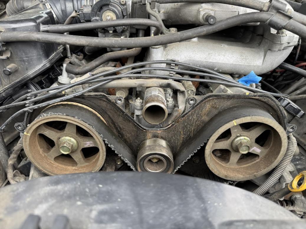

Once home, we got to work tearing it down. The timing belt got chewed up because the water pump pulley was failing and walking the timing belt off the other pulleys. It had zero compression because the timing jumped and was off. After replacing the timing belt and water pump and fixing the timing, we fired it up and it ran.... like garbage.

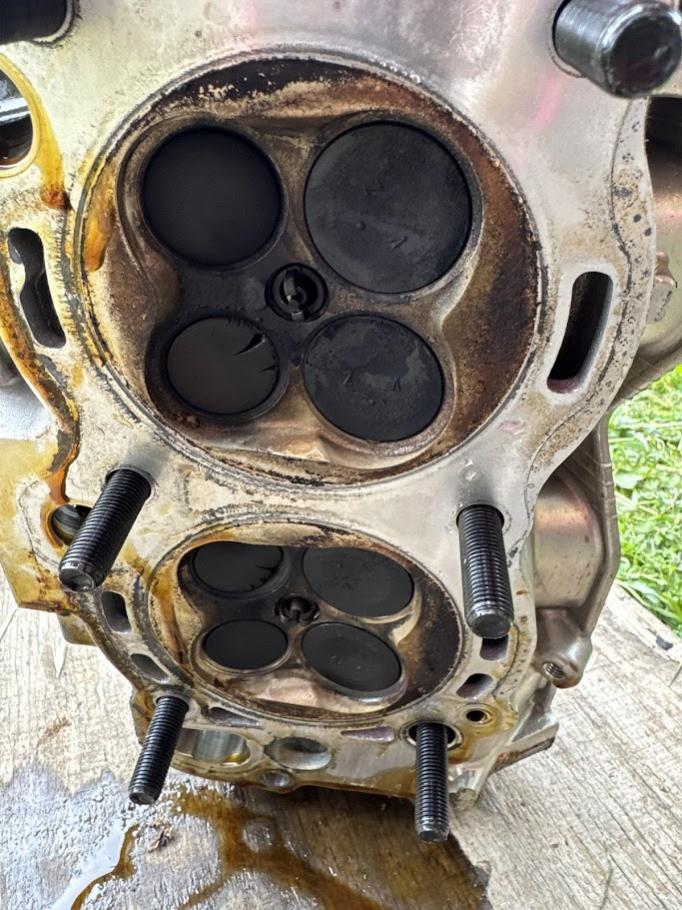

Cylinder 5 was dead. Then we were concerned if this was a top end or bottom end issue. Took the heads off and uhh..... the valves were toasted.
