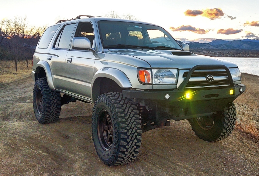

Posting in case anyone is curious on what icon #700 coils and LC 8.25 wraps looks like. Tires are 295/70-17
