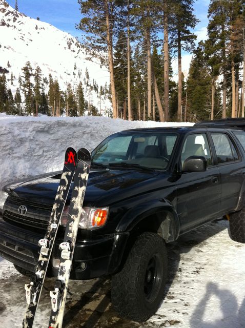

Went with Toytec Ultimate lift and wheels and tires at the same time, very happy with the result, next up the bumper but from what I've heard the "must have" shrockworks bumper has a long lead time
