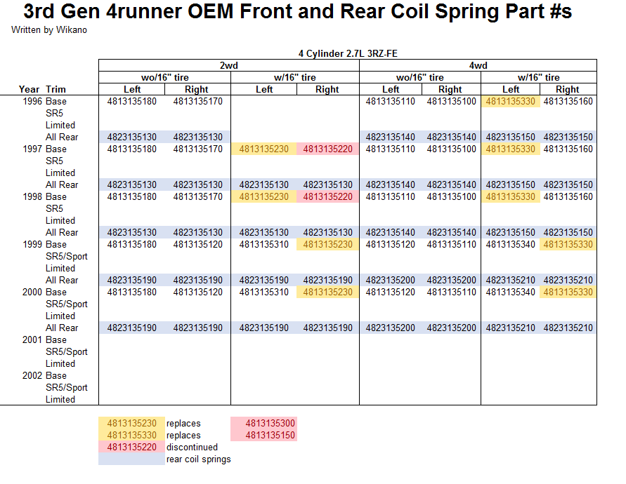

All 3rd Gen 4runner Oem Coil Spring Part Numbers
Feel free to comment on any possible mistakes. :whipping2
I noticed that some sites were not consistent in their labeling but I did my best to cross check the numbers with alternative sources.

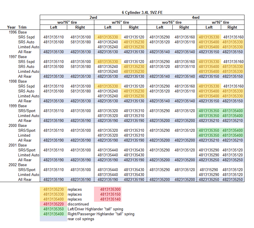

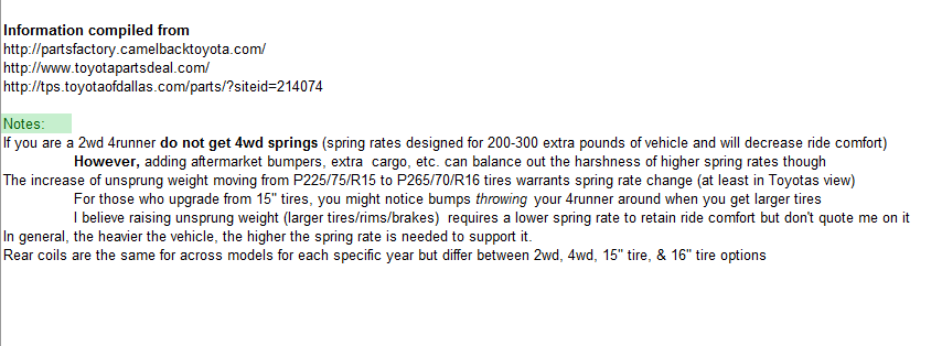

Thanks so much for this, 7 years later! Anyone care to put the color codes next to the part numbers? Long shot I know. I'm really just trying to figure out the difference between the front springs on my 2000 V6 4WD. They are pink/white and yellow/white. Which goes where?
