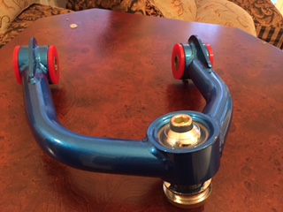

So, awhile back I went ahead and bought the Ebay UCA in order to tell whether they were worth the investment and potential risk of not being perfect. About 5 months later, here I am writing a review:
*Here is a link to my YouTube review*
https://www.youtube.com/watch?v=jCI9g9zCwTI
Pros:
- Inexpensive alternative to TC UCA ($350) USD
- Robust
- Improved design over previous model(s)
- Durable
Cons:
- Risk Factor
- Unknown supply
- UCA Thru bolt was 1/2mm too small for bushing sleeve
- May require bushing replacement in order to fit perfect.
My application:
Early model 4runner (1996) 3rz-Fe 5 speed M/T
Fitment:
As stated above the main issue was that the mounting thru bolt for the UCA was 1/2-3/4mm too small in diameter. The remedy for this is to replace the bushings with a bushing and sleeve kit from All-Pro Offroad.
Misc:
I will be the first to say that they were a different color. The current blue color on there is not my taste and they will be getting a fresh stripping and powder coat to be metallic grey.
Conclusion:
If you are someone who does not mind problem solving this can be an alternative to buying $800 control arms. This may also apply if you are a broke college student looking to keep upgrading your rig to get away on the weekends and wheel with your friends whom are out of college making substantially more money than you. I can say, yes, I would recommend these to someone who is willing and able to work around minor imperfections.
My Rating: 9/10 :peace:

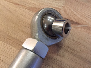

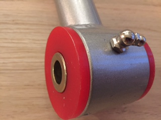

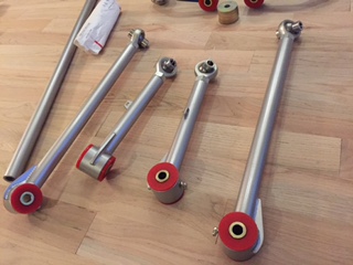

Here's a few quick shots of the rears:
They're of close to top notch quality!
When the heims go, I will upgrade them all to FK heims.
All in all $400 is an expense I was willing to take for what I got! So far they ride really well! :bump:

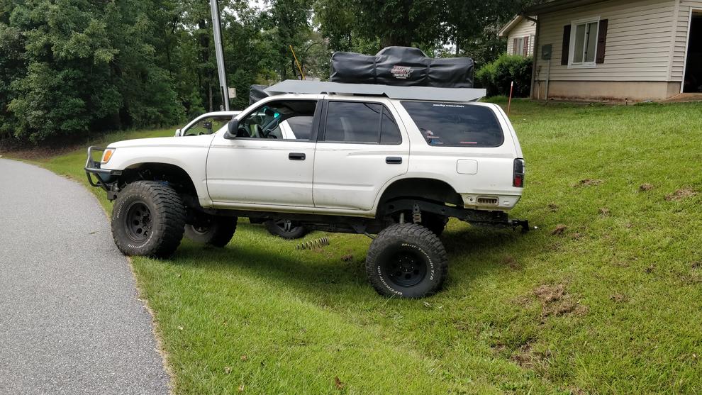

They've held up incredibly. Over 20k miles, no problems. Time due a rebuild, note you will need to find misalignment spacers for the Toyota hardware because the misalignments that are on there are not the correct inner bore. They are super strong. It pays to be a guinea pig every now and again

I have been extremely hard on these uppers. There's no other way I can describe how I have treated them. I have easily done 4,000 miles of dirt driving in rough terrain here where I live. On top of all of that, a lot the rough driving I have done has been at a high speed. I will admit there have been moments where I hit corrugations thinking my whole truck would rattle apart. I was pleasantly surprised when I did my torque inspection to find that everything was within spec. Its been Over 20,000 miles since the installation.
