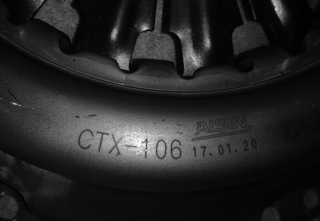

Do you see Aisin embossed to the disk or printed?

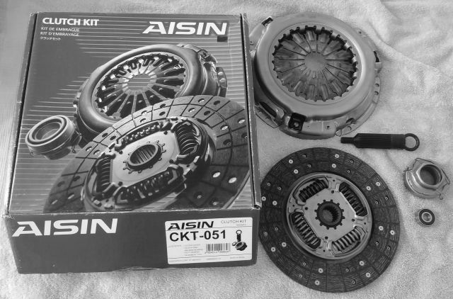

I'm in the middle of a clutch job started last night where I'm looking for help in how to remove the starter which made me find this thread and I can confirm that the Rockauto Aisin clutch kit is stamped Aisin and it has legit looking packaging (Aisin disc & diaphragm, Koyo pilot and release).

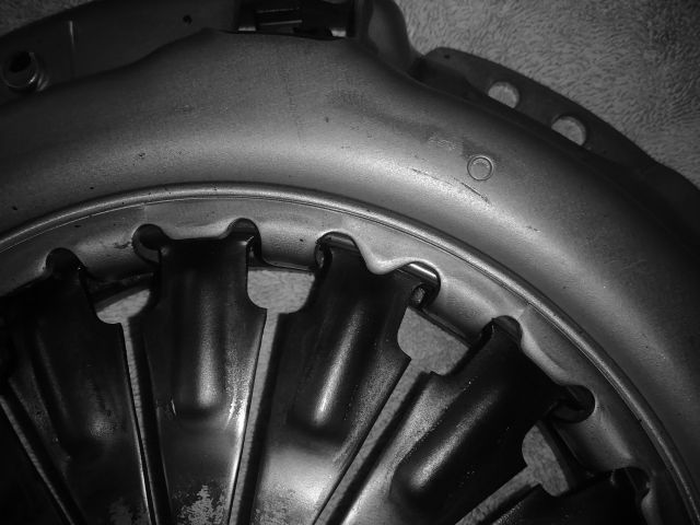

Anyone know if this round dot has any significance to us when putting it in?

Not that I'm aware. All I know for sure is the THICKER more portruding end of the disc itself goes TOWARDS the flywheel. My disc was stamped "T/M side" (for transmission side) on the wrong side. Boned me bad on that one

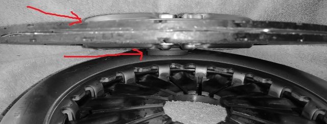

Thanks for that hint about the thicker end of the disc facing the flywheel as I have never done a clutch job before so I don't know even the simplest things to look out for.
The disc does seem to be asymmetric in that the splines stick out more on one side and the springs stick out more on the opposite side.
I'll compare with the original once I get the starter bolts figured out and the bell housing disconnected later on today.

The Aisin clutch disc I have is definitely not symmetric.
The asbestos that grabs appears to be symmetric, but not the metal parts.
The springs visibly stick out on the first more than on the other.
The spline visibly sticks out on the second side more than the first.
