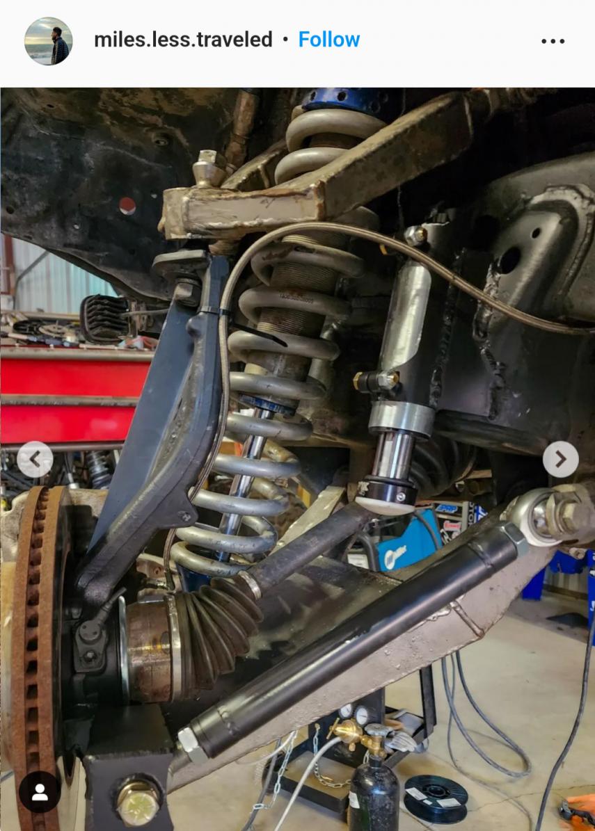

I asked my friend and he confirmed it's the "Tacoma" clevis kit he bought. I'm sure you could convert the setup to the same heims at some point, the misalignment is really the determining factor for width/bolt size. At the beginning of October we changed the orientation of the spindle side heim so the bolt is horizontal. I would be curious how far the uniball conversion allows the suspension to travel, since it was limiting our droop so we couldn't run a normal straight tie rod, which is why we reoriented the outboard heim so it wouldn't bind and we could use a stronger (straight) tie rod. Just something to keep in mind.
right you start with the misalignment bolt stack size then pick a Heim.
I guess i was not thinking about the knuckle side but yea I guess that might bind up as well. the TC setup would let me run both heims horizontal with a little grinding and welding.
have you ever considered j-Arms style uppers? I think it's interesting how they also run the uniball horizonal in a lot of cases. makes a lot of sense really. at first I was like hey your uniball is on it's side, then... oh yea hey.

The 1st gen 4runner arms that I posted in response to that other guy above is actually a true J-arm upper and has the uniball integrated to the upper arm in the orientation you show. Additionally I have a 3rd gen design I've been slowly working on that I call the gen 2 that is very similar to what you posted and utilizes a fully fabricated spindle with 4th gen unit bearings and uniballs in that orientation.
The uniball best reacts loads radially through the race. The uniball being on its side (in regards to the bolt) is mostly advantageous on the top since the top arm is usually shorter and needs more angle capability than the lower. Since the upper has relatively low loads and is only reacting frontal and radial loads at the hub (ie not holding up the truck) it's less critical the orientation of the joint. The lower joint being the more heavily loaded of the two has more argument of the best joint orientation. With that said there are lots of vehicles that run the joint horizontally on the top and the bottom (specifically Ultra4s) where hub frontal loads would be reacted axially in the bolt direction, and plenty that run it vertically (trophy trucks) where vertical suspension loads are reacted through the bolt. Uniballs have lots of load capability in every direction (minus pulling towards the c clip) so maybe it's a moot argument either way, and probably more important to just optimize which way you'd rather not be angle limited---which again is why most uppers at least have the bolt horizontally, since the suspension travel would be limited far more than the steering would be limited.

The reason they are 3.5" wider per side is so you can use the 3.5" longer Tundra CV's. Custom axles will be required for 2" wider arms. A true upper J-arm will require way beefier front mounting point. You can't just cut the back side off of this A-arm and call it a J-arm. You could possibly die if you do that.

This is the original long travel I did for more reference. As you can see the UCA is just some sections of square tubing (4 in total as I recall) with miter cuts that wraps around. Very simple, though harder to get good uniball misalignment since I just took a hole saw perpendicular to the arm. You can also see the LCA setup, again square tubing skeleton and then I just had a single plate welded to the bottom. The arm was completely flat, no kink, which required cutting out the bump stop area of the frame to utilize more up travel where as a kinked arm can get around the frame. You can also see I cut out the stock shock towers, which was a mistake but I was trying to stuff a 10" shock for no real reason (I was like a sophomore in college with no money or tools, thus why everything is square tubing). I wouldn't recommend doing a lot of this, but just other options of ways to do things. Never had any issues with these arms, they're now hanging on my wall. Spindle has always been the weakness of the 4Runner.
