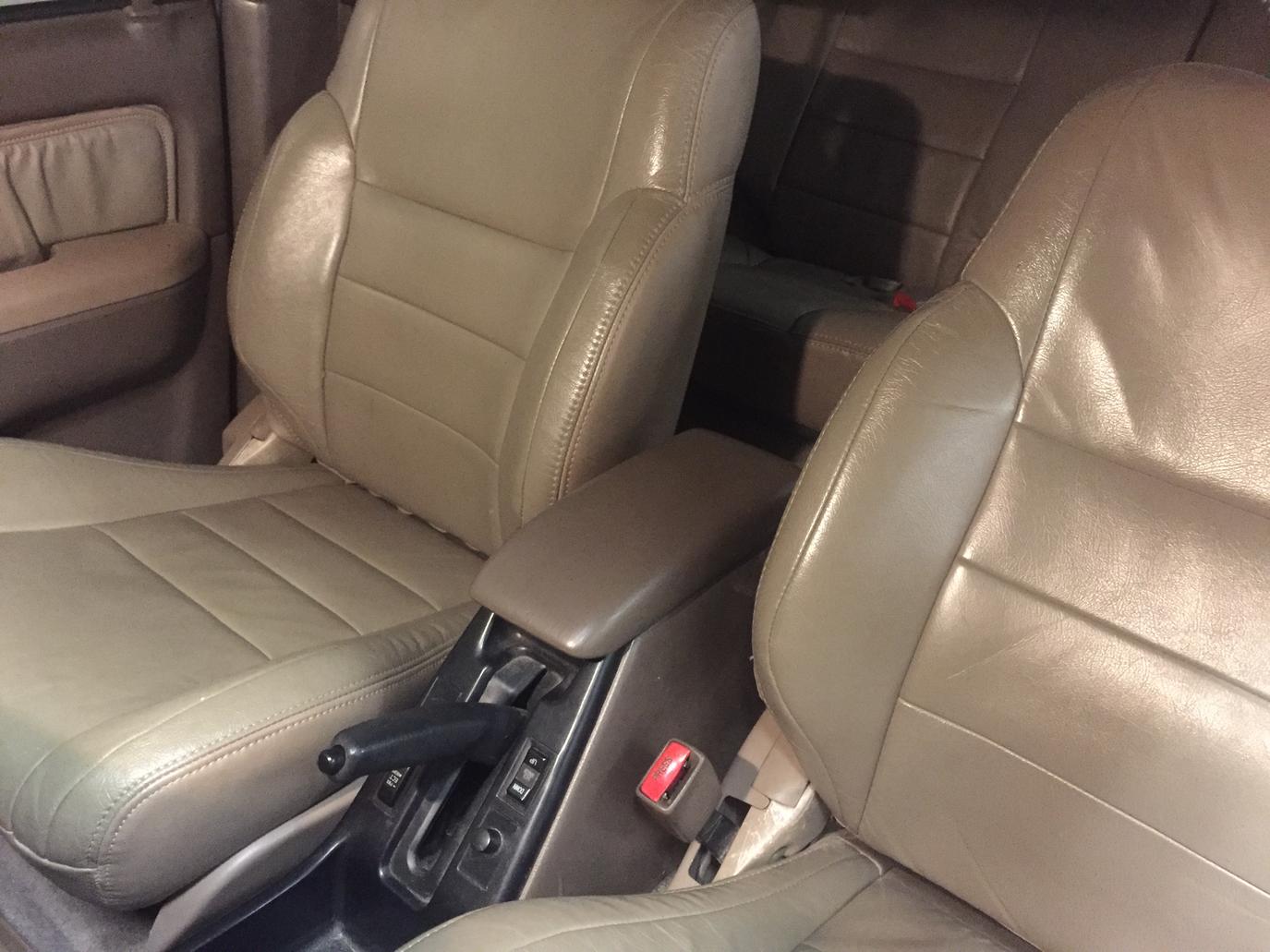

Concerning OEM, there only 2 part numbers, 1 with leather option, and the other with the non leather option.
Plastic one installed
I had the same issue with my old leather cover. At the time when I ordered a new one I didn't realize there were different part numbers and ended up with the plastic version. From experience, after having leather for so many years you will not be happy with the plastic one. It has a much cheaper feel. I kept my old leather one and will be recovering it with black leather when I change my seats and door panel inserts to black as well.
If the structure is soft when placing pressure on it, remove the little (eyeglass sized) screws from the underside and separate the bottom plastic panel from the leather covered top. Check whether the top plastic panel is cracked. There is the leather cover, a contoured foam padding insert underneath, and then the plastic upper panel that supports the foam and leather. If that plastic upper panel is cracked, you'll need to do something about it before recovering.
Here is what the plastic/rubberized version looks like installed in a leather interior. It works, and nobody else would probably know the difference, but you'd be longing for the old days when you had a leather arm rest.
