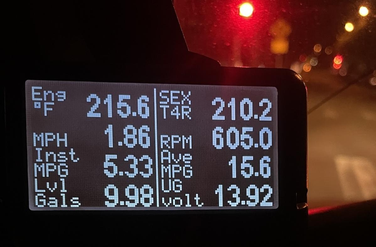

I had purchased my 3rd gen with 232K miles on the clock back in 2016. I then ordered a scan gauge which showed 202-207F as the operating temp for my engine. After draining the radiator, I took a peak at the thermostat and the jiggle valve was oriented at 3pm. Placed the new thermostat in with the jiggle valve @6pm and refilled new coolant. The new temps were 186-191F. Huge difference!
Then in 2021 I took my car in for a timing belt/water pump job and upon completion, on my way home, the scangauge reported 210-215F temps. When I reached home, I drained the radiator again and looked at the thermostat, this time the jiggle valve was at 12pm position. Again, flipped it back to 6pm and refilled old coolant, and bam, back down to 188F.
As for what a "normal" engine temp is, I would think anything from 170F-220F can be considered "safe". I think those that are supercharged run hotter than smallfolk and do require an 170F thermostat.

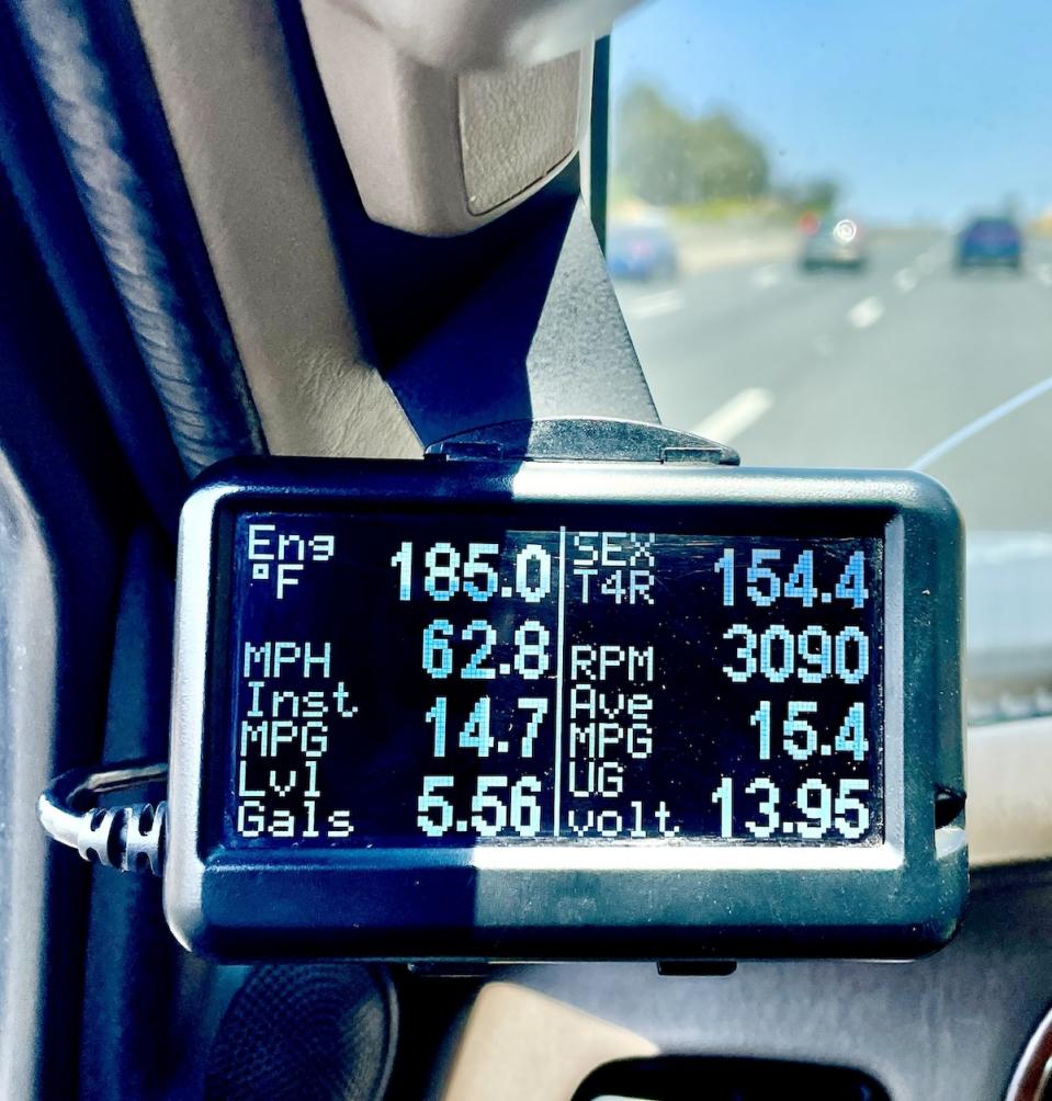

I've been running into similar issues with my vehicle, but I attribute it to being gifted an UltraGauge and now I stare at the temp fluctuations constantly!
I do have 285s, plate bumper, trans cooler, min. decade old radiator/cap, and hover between 190-200 most days - short drives, stop & go, offroad often, etc.

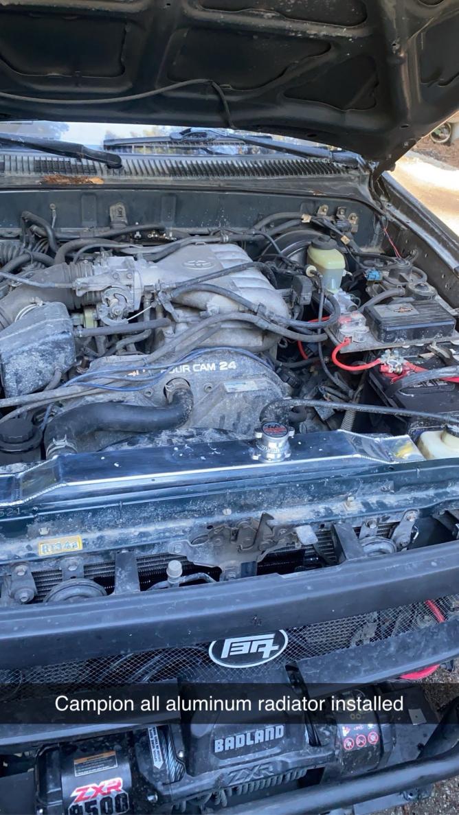

Update
I installed my champion today temps are down about 10 degrees or so sitting around 194, lower but not quite as low as I'd like. I'll give another update when I install the new thermostat I tested my fan clutch and it seems fine but I'm going through all the trouble so I figure I'll replace it anyway with an OE replacement.
194*F is not high. How much lower do you think it should go when your engine has a 180*F/82*C thermostat? The thermostat regulates the INLET temperature of the engine, and the temperature of the OUTLET is where the sensor is for the ECU. That ~10-15*F rise is the heat getting transported out of the engine by the coolant.
There is no reason to run the engine colder... (assuming you aren't supercharged, running on the edge of pinging during regular use...) If the temp is 'rock sold' - running up and down only a few degrees under most usage conditions, your cooling system is working well. When the jiggle valve is in the wrong position, temps go up and down by a much larger amount while driving which tells you something is wrong.
As a secondary note, the factory gauge is basically a 3-position indicator - too cold (<160*F or so), fine (160-215*F) and too hot (>215*F). It doesn't show any minor fluctuations, by design.
All of this is somewhat specific to the 5vz engine - every engine runs a bit different with ideal temps, normal temp fluctuations, etc.
I went the Koyo Aluminum radiator route. Like you, my engine temps improved with the aluminum radiator. I'm happy I went with it.
