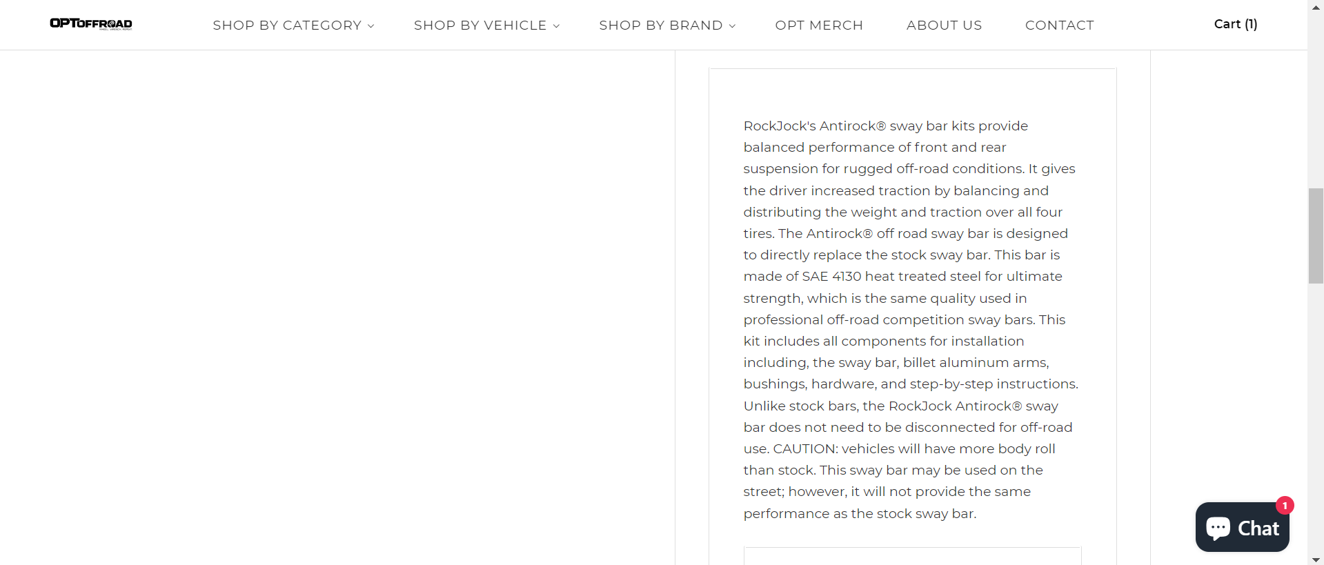

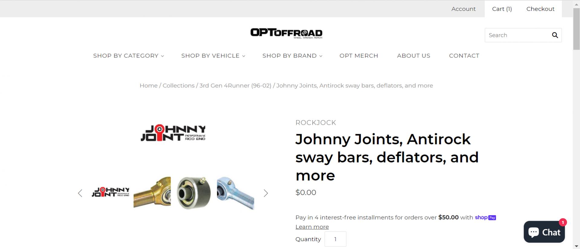

Has anyone else seen this on OptOffroad yet? In the 3rd gen second on the 13th page there's a listing for "Jhonny Joints, Antirock sway bars, deflators, and more" I was scrolling thru the 3rd gen page one day and saw at the end that listing. I got really excited seeing anti rock sway bars on there. I know I wouldn't be the only one who would be stoked for anti rocks on my 3rd gen 4runner! Would be absolutely awesome. Am I just tripping but i'm sure the point of that listing is to show stuff that Jason is going to be adding to the website... like stuff to come. What do you guys think?

I remember someone made them for our vehicles, so it could possibly be an old product listing they didn't fully remove from the site. Been a few years but I definitely remember seeing them somewhere, and I remember a user or two running them here and there

Well typically for our toyota trucks when you lift them and put different suspension on you are going to need longer sway bar links to compensate for the lift so they aren't at a crazy angle and also so they aren't limiting your suspension travel. The idea is that the antirock sway bar is a regular sway bar but with off roading in mind, so you still get less body roll but not at the sacrifice of offroad performance. I have no idea how they work either lol but they do and seems like they do well.
My WAG would be lower torque at deflection on that bar than stock.
It does say there will be increase body roll.
