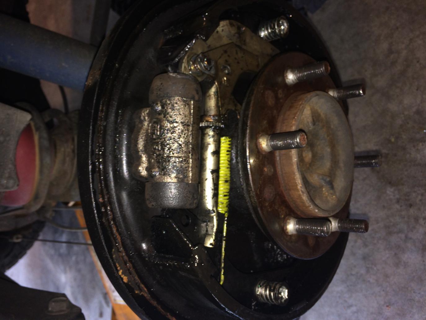

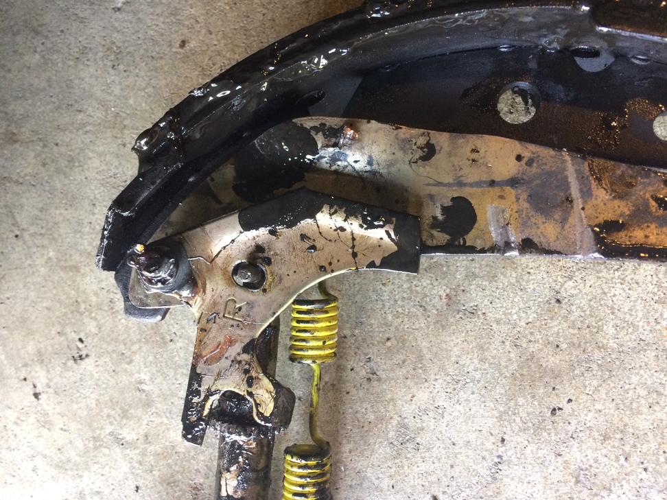

I opened up the rear drivers side drum and the spring that holds the adjustment level was broke. replacing it, adjusting rear brakes, hope it's that simple.
Turns out passenger rear brake adjustment lever snapped in half, and the loose piece gouged my axle seal.
Rear brakes replaced, and adjusted. Truck stops as it should now. However rear axle seal is still leaking Mobil 1 diff oil into passenger drum. FML, still don't understand why adjustment lever snapped in two.
