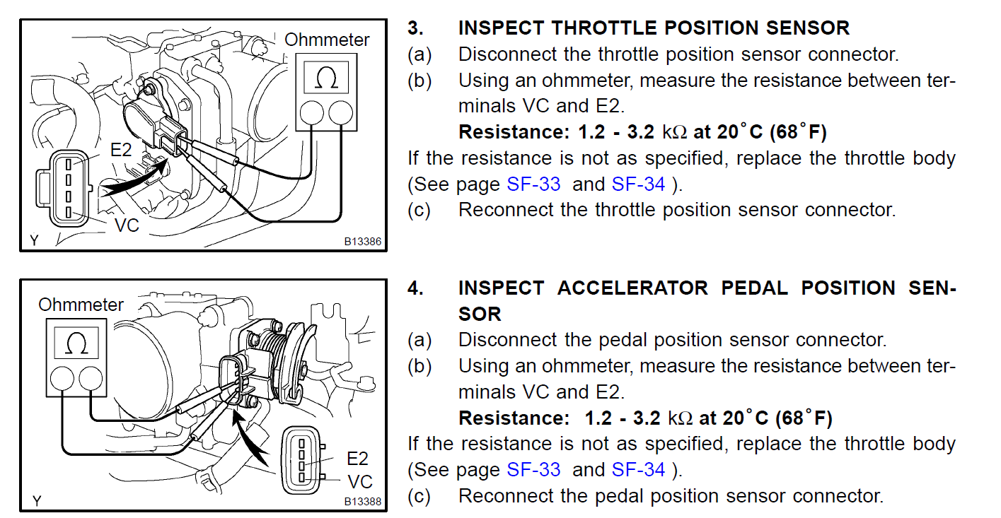

I think you are referring to the accelerator position sensor, instead of the throttle position sensor.
I agree the Throttle Body basically has to be replaced if it's the accelerator sensor that has gone bad. I will know soon.
I actually have a spare throttle body (entire engine and supercharger actually) so either way I will have this fixed shortly.
