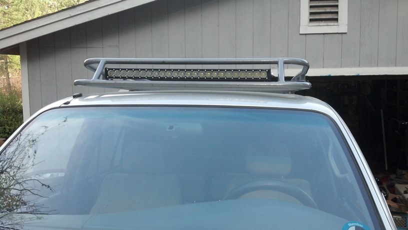

A 40" one fits perfectly facing the front and will mount to the stock roof rack without any mods, you can also mount 30" ones without any mods facing to the sides on the stock rack. You just replace the rack mounting bolts with the bolts used to mount the light bar so they hold the rack down and the light bar down.
2AC8B832-E201-4AC7-B45C-577B62ED4BAF_zpsrn8ynyxp.jpg~original
B5BEFCB2-AA91-4FDB-B0A8-6FE6C2AE2284-639-00000061BAD1E871_zps2015cc69.jpg~original

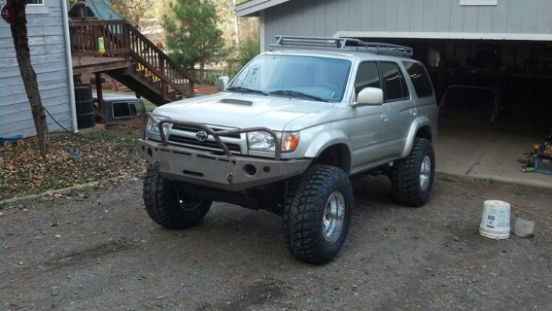

Here's my 30
