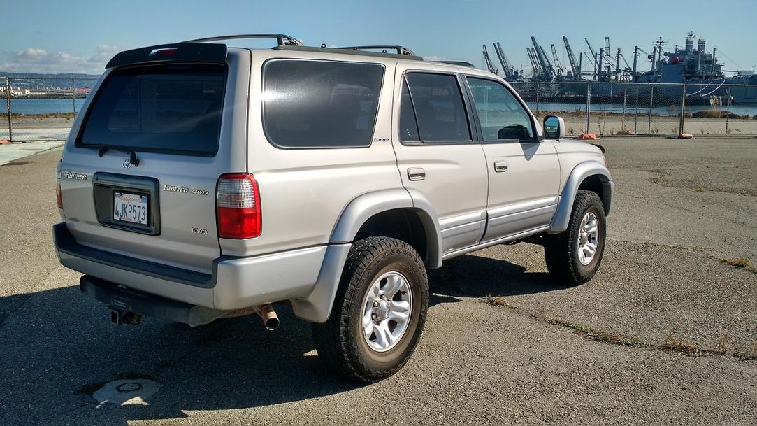

Both
The 881s were too stiff b/c i had no weight up front and the bilstein 4600s were underdamped b/c the coils werent preloading due to the lack of weight.
The way to go if you can spring for it is the trd tundra coils on tundra 5100s. best damn ride around. Yeah they dont yield a much instant lift but the ride and on/off road performance is great.
PS sniff..sniff...
