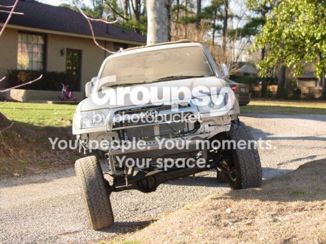

I used an FZJ80 axle for my sas,
axle- 1000
rebuild steering knuckles- 250-300
Johnny Joints and misc hardware- 200
IFS steering box- 75
Bilstein shocks- 150
new brakes- 150
Not to mention brake lines, power steering hoses, shock towers, coil buckets, link brackets, paint and an assload of time for research and fab time. Once you have all that done you get to buy big tires and new gears, so yes it gets exspensive quick. Its kinda like getting a free puppy.
